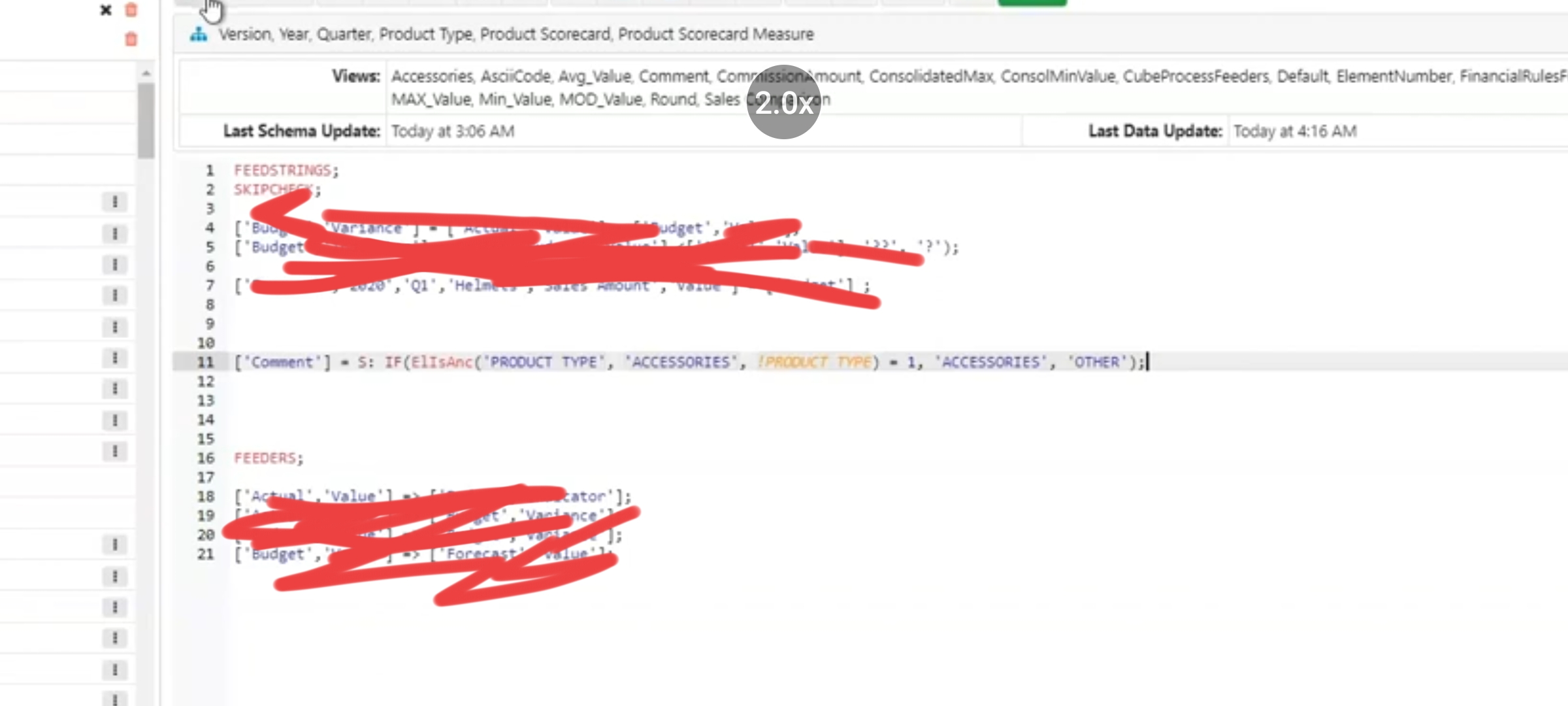

We can write N: right instead of S : for string element 'comment'
Re: Tm1 Rules for string element
sairajsoma wrote: Fri Feb 14, 2025 8:39 am We can write N: right instead of S : for string element 'comment'
So is that a question?
Or a statement of fact?
Do you have an issue with writing a string rule?
You can use N: it won't be a syntax error, but it also won't do anything! If you want to assign a string value to a rule calculated cell, then you must use the S: qualifier (and the cells in question defined by the area statement must in fact be string cells! Which means the element type of the last dimension must be S.) Oh, and don't feed string rules! Feeding is for consolidation. As text doesn't consolidate there is really no reason to feed a string rule, this just wastes memory and increases compute time.
As of now I'm confused what you actually want to ask.

okay got it. this was the full ques actually. thansks!!
Screenshot 2025-02-15 194427.png (197.4 KiB) Viewed 33648 times
