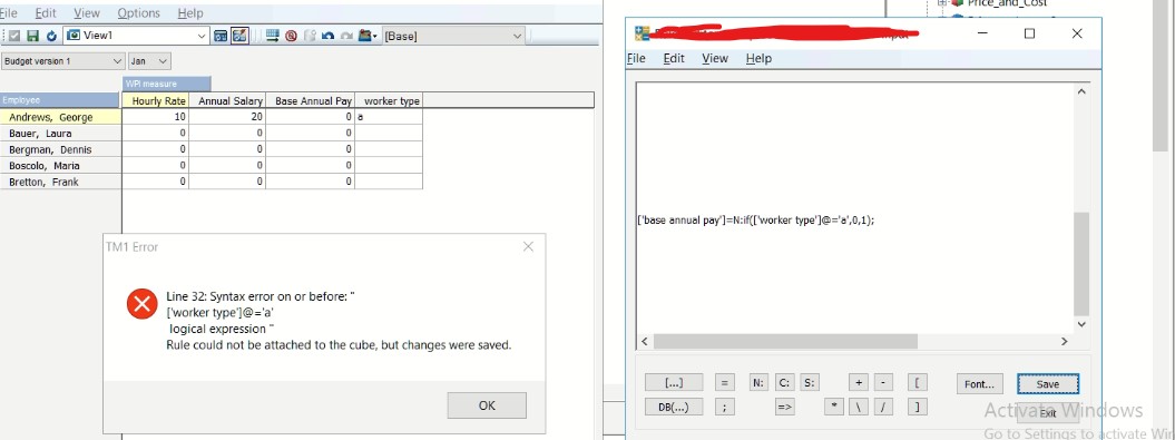

skipcheck;
'base annual pay' and 'worker type' are element of measure dimension. 'worker type' is string element having 'a' value at one intersection. while saving rule i am getting syntax error. could anyone find the error.
['base annual pay']=N:if(['worker type']@='a',0,1);
Screenshot 2024-11-06 201843.jpg (63.33 KiB) Viewed 10333 times

Use the DB() format when referring to a String measure

sairajsoma wrote: ↑Thu Nov 07, 2024 5:27 am skipcheck;
For String Measures, you need to use DB function.

Okay, Thanks
