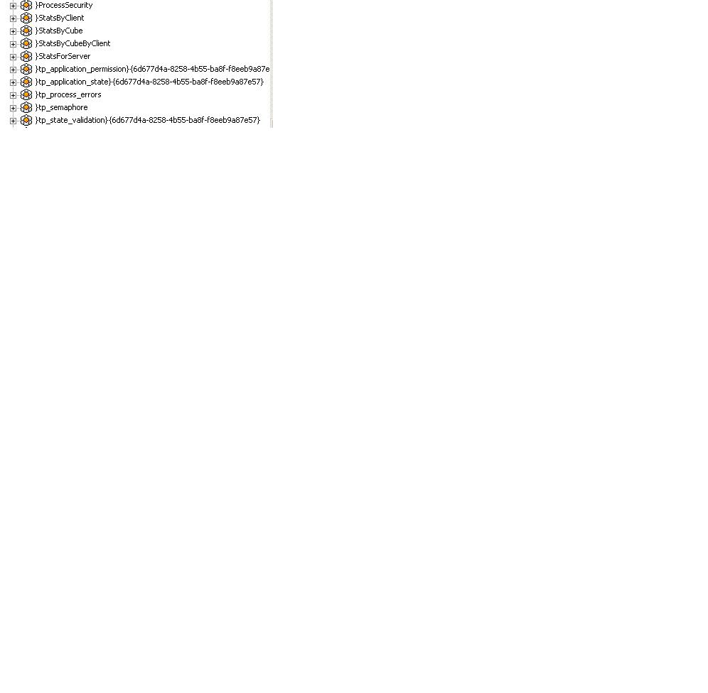

Display > control objects & you will see the process }tp_admin_delete_all, note the script deletes all the contributor control cubes & dims. Handy if you want to start afresh.

Hmm, I cannot find }tp_admin_delete_all at all
It's a TI Process, pls move down at "Processes"

Thanks all. I found it.
