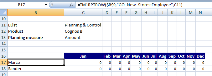

I have a worksheet(active form) in tm1, which I use both in excel and in Tm1Web, the form looks like this;
As you can see in the TM1RPTROW function in cel B17 I refer to cell C11. I do this to get the right subset in this function.
This all works fine exept I have to rebuild the worksheet every time I change the value in cell c11 to recalc the TM11RPTROW function, recalc doesn'tdo here.
Is there any possibility to automaticly rebuild the sheet after a change in a selection, i don't want to use a macro because I also need this functionality in Tm1Web.
I've looked at the TM1REBUILDOPTION, but that's only a solution when the file is opened.
Can anyone help me out here? TIA!

sander wrote:Is there any possibility to automaticly rebuild the sheet after a change in a selection, i don't want to use a macro because I also need this functionality in Tm1Web.
Just use a TM1 action button that rebuilds the form as it's "action". It will work in both Excel and TM1Web.

Tomok, I've seen this also, but this is not 'automatic', what I want is when I do the selection the sheet automicly rebuilds. What happens here is, I make a selection and then I have to click on the action button.

sander wrote:Tomok, I've seen this also, but this is not 'automatic',
It may not be automatic but it's the only option that will do what you want for TM1Web.

OK, we will have to do it with this functionality. Thnx for your replies!
