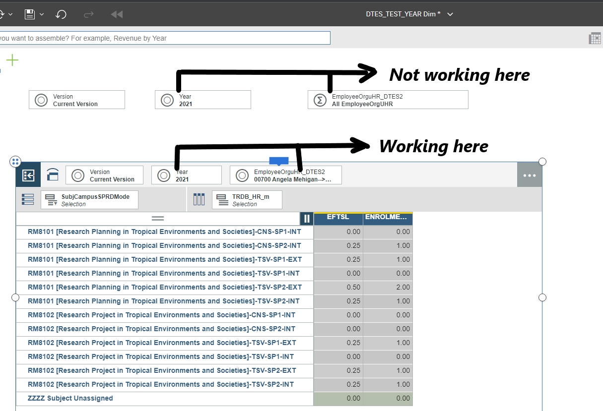

I have created a dynamic subset filtered attribute(YearNo attribute on Employee Dim, and attribute value is an element from other dimension (Year dimension). When i placed the Employee DIM as Row or column its working fine based on the Year Dim filter which is at TITLE. however its not working when i placed both the EMPLOYEE and YEAR dimensions at TITLE (context).

This is for PAW only, it is working fine when both YEAR and EmployeeOrguHR Dimensions in TITLE/filter. however, as you said, it is not working when i Drag EmployeeOrguHR dim out of the view and made them as a external filers(generic filters for multiple widgets on the same dashboard).
Is there any way to get that working? either by changing the MDX or changing something in PAW?

No. Somebody has already asked this on IBM community forum: IBM said that when you drag filter to external widget, MDX becomes disconnected from view.hisathishkumar wrote: ↑Mon Jan 24, 2022 11:39 pm
