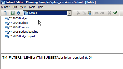

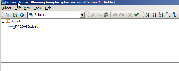

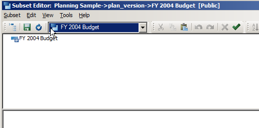

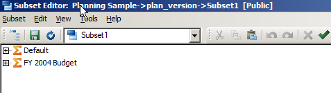

Ok, here is the example.
Default is dynamic subset and FY 2004 Budget is the static. I created a static parent Subset1 to include both. After server restarts, the Subset1 only has FY 2004 Budget left.

Re: Mix Dynamic Subset with Static Ones
after restarts
