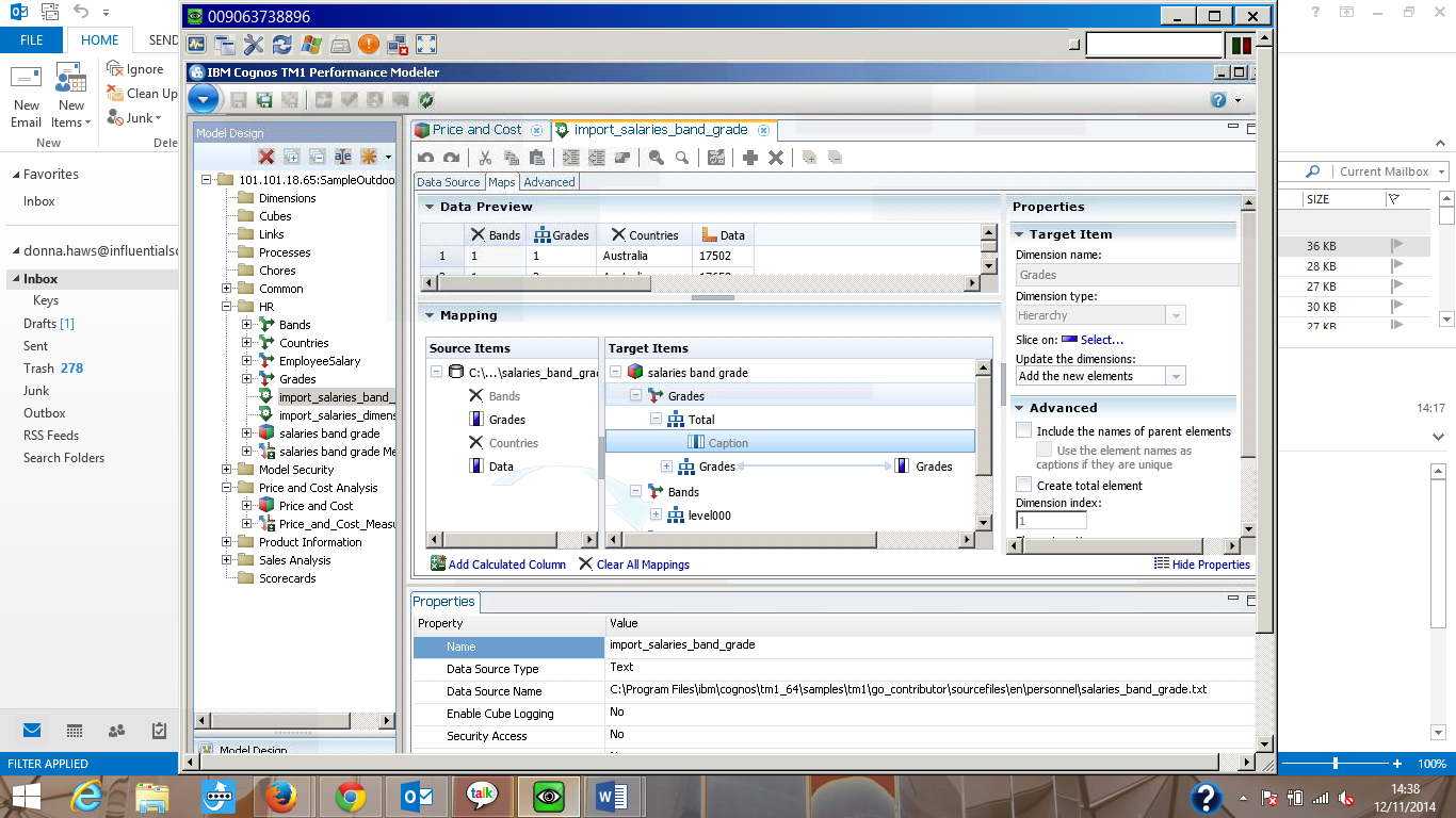

What exact version are you using? Can you post a screenshot of your "Maps" tab from PM?

Hello, thank you for your comments. I have attached a screenshot of the maps page. The total has a caption. Could this be causing the issue?
(I am trying to remove total element from the Grades dimension. I can untick the box just fine, but after saving, the box reverts back to being ticked.)
Thank you again
