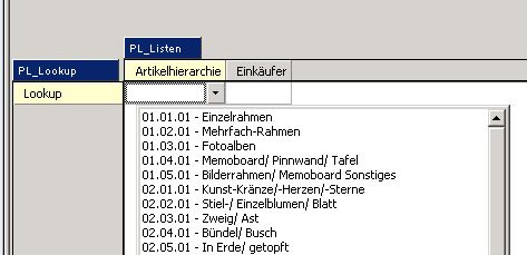

I have a question about Picklists in TM1 9.5.2 with Excel 2010. I defined a Lookup-Cube where I want to define all my Picklists because they are not used in an active form. They are used in the static area of the Sheet. The picklist works in Cubeviewer:
Screenshot Cubview
Screenshot Cubview

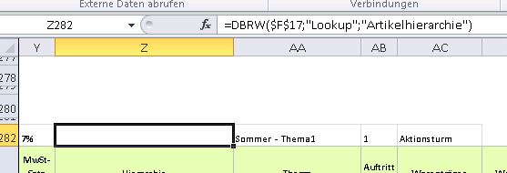

But if I reference the Cell i Excel with a DBRW the Dropdown does not appear:
What am I missing?
Thanks in advannce

It's not sliced. I inserted the DBRW manually in an existing Excel.
Oh, in the Moment I pressed SUBMIt I got the question. If I slice it down it works. A hidden Tab is created. But even if I create the Tab manually in my existing Excel and create the Datavalidation it does not work

It semms to be a Problem with the Excel-Cell/Row7Column. I put the DBRW-Formula in another cell and that works. I test a bit more

I've really no idea what was the issue. I put the DBRW-Formula in another Cell and it works. Beside a border the cell had no formatting.
