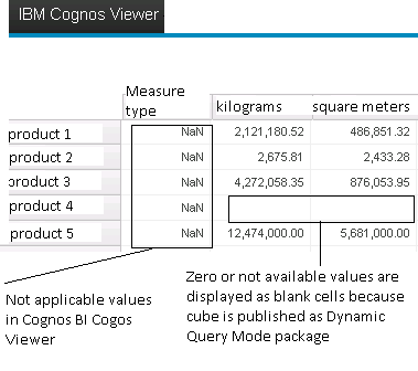

For top member Measure type the value is not reasonable - there should be no sum of children, because there would be apple and organge sum like problem. In Rules Editor I have written the following formula:
['Measure type']=0;
but end-users complaned that 0 should not be used in this case but some "not applicable" like N/A should be used instead.
So I changed the code to:
['Measure type']=0/0;
Because of matematical division by zero problem the result is #N/A. This works fine! Bellow is a simplified sample in Cognos BI - Cognos Viewer. It is clearly seen the difference between zero values or not/available AND not applicable.
The code is working excellent. There is a small problem that I as a perfectionist don't like, this rule code is hard to read - specially by non-author of the code - because it it a trick, workaround. Is there any other way to set N/A value directly like for example: ['Measure type']=N/A or something similar, to make a code more readable?
Thanks a lot

@Wim Gielis, thats it! Thanks a lot, so solution is:
['Measure type']=UNDEF;
This is more readable (comparing to my dummy mathematical formula division by zero), becasue everyone can read the UDEF definition from TM1 Reference Guide.

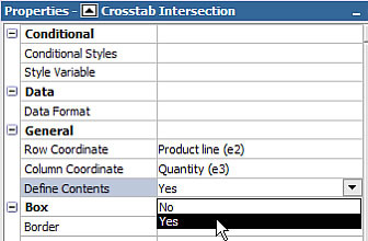

Foremost of all, you can display text in a crosstab! Yes, it is possible. Several years back I had done it. Refer to this IBM KB in achieving it -
http://www-01.ibm.com/support/docview.w ... wg21454433
Secondly, unlock your crosstab, and define the content of the intersection to "Yes"
Drag and drop a string from available objects and put your text. See a sample output below :D

@sachin, I need to have this solution in cube not in report. End-users can create new report and this "zero" problem should also not appear new reports.
