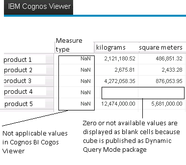

#N/A. This works fine! Bellow is a simplified sample in Cognos BI - Cognos Viewer. It is clearly seen the difference between zero values or not/available AND not applicable.
- cognos_viewer_not_applicable_sample.png (8.12 KiB) Viewed 17337 times
