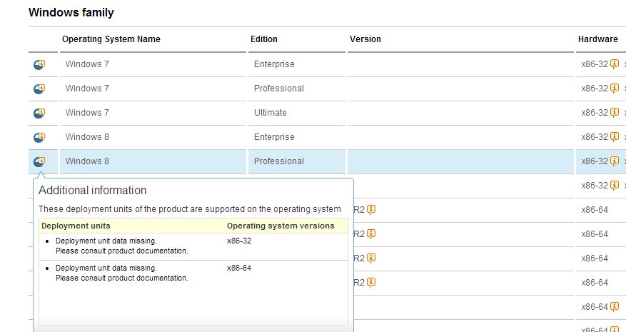

Hard to tell. The new and glossy IBM Software Product Compatibility Reports (SPCR) tool (which is used by their Supported Environment page) generates content that is at best cryptic and at worst unfathomable.vensyd wrote: Am trying to install TM1 10.2 64b on Windows 8.1 64-Bit but its throw an error saying:

Considering that I do indeed have a 10.2 test environment running on a 64 bit Win 8.1 (cursed be its name) box, whether it's officially supported or not is less of an issue than the fact that it works.vensyd wrote:Or is there any alternative way to install this?
Provided, of course, you install it under an Admin login, and run the install "As Administrator".
