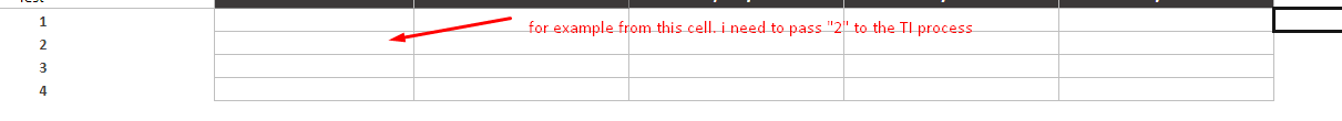

May be somebody know how to pass a dimensional element from a TM1RPTROW row to a parameter in a TI process via an Action Button?
I try to do it using OFFSET function. But it does't work.
Could someone help me?

Have a look at the attachments. In Example.xlsx have a look at the tab Bank Statement Review, in cells C11 to C13, I am using offset to return the the values from within the active form... In this example I wanted the user to select a row, and for that selection to drive parameters for a process and navigate and set properties on another form (BACS entry detail). This example was built in perspectives, so for those with PAX, I have provided screenshots the BACS Entry action button.
I created a named range called rng_start from cell D26 to Q26 i.e. the titles for each column on the report and then used this in the offset function...
in c12 i have this formula
=OFFSET(D26,@CELL("row")-@ROW(rng_start),8)
This is saying to start from cell D26, and navigate down the number of rows between row 26 and the row the user has selected... in your case if you want the second row of the report, then it would be =OFFSET(D26,2,8)
The 8 is how many columns to to the right of D26 do you require data from. If you needed something from column D then it would be 0, column E then it would be 1 ...
Once you have the data extracted using offset, you can then map those cells to the parameters of your process.
