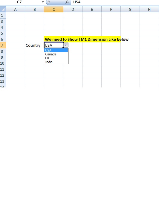

Re: Dimension elements into Excel cell drop down
Thanks for reply.
We tried with Subnm(),Dimix functions,but there are not working the way we are looking for.
Please find the attached screen shot for reference.
Sathish
Thanks for reply.
Sathish
- Dimension in ExcelDropdown.jpg (40.6 KiB) Viewed 5942 times
Look in the manuals for the word "Picklists".sathishh.mk wrote: Thanks for reply.

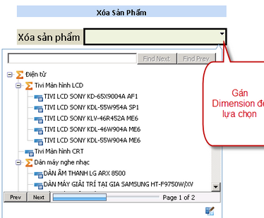

- h5.png (64.96 KiB) Viewed 5861 times

I appreciate that as a new member here you're trying to help, but to ensure that we retain high quality answers you do need to read the question carefully and be sure that you're replying to what the question really is.binhnguyenthy wrote:hi
You can use SUBNM funtion, before You must connect server TM1.
=SUBNM("Retail:Product","All","1","VN")
http://pic.dhe.ibm.com/infocenter/ctm1/ ... D5_2_6_6_9
After you run it on TM1 application, you can see what you want
In this case the question was about creating a drop-down list in a cell in Excel, as the screenshot in the third post.
You've provided a link to a TurboIntegrator function which inserts new elements into a dimension, and a screenshot of what appears to be TM1 Web. The two don't seem to be highly connected to the question asked.
