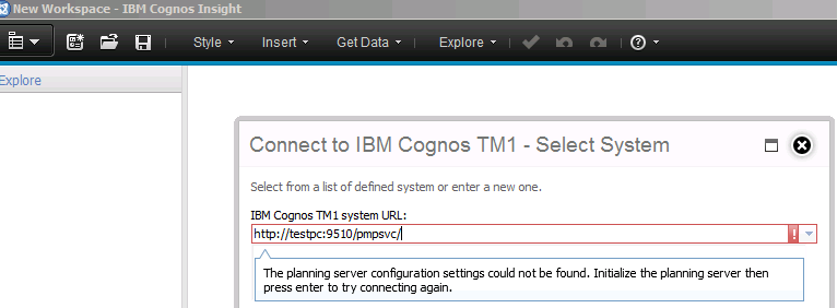

Hello, forum.
I got a problem that I cannot find how to solve.
The planning server configuration settings could not be found. Initialize the planning server then press enter to try connectiong again.
I tried to put "localhost" to the string but with no success
Has anybody met this one?

Have you tried pasting that URL into a browser? If so then it might redirect you to the configuration page where it will create the file it is looking for.

http://localhost:9510/pmpsvc opens ok...
IntegratedSecurityMode = 1
is BI necessary to Insight work?

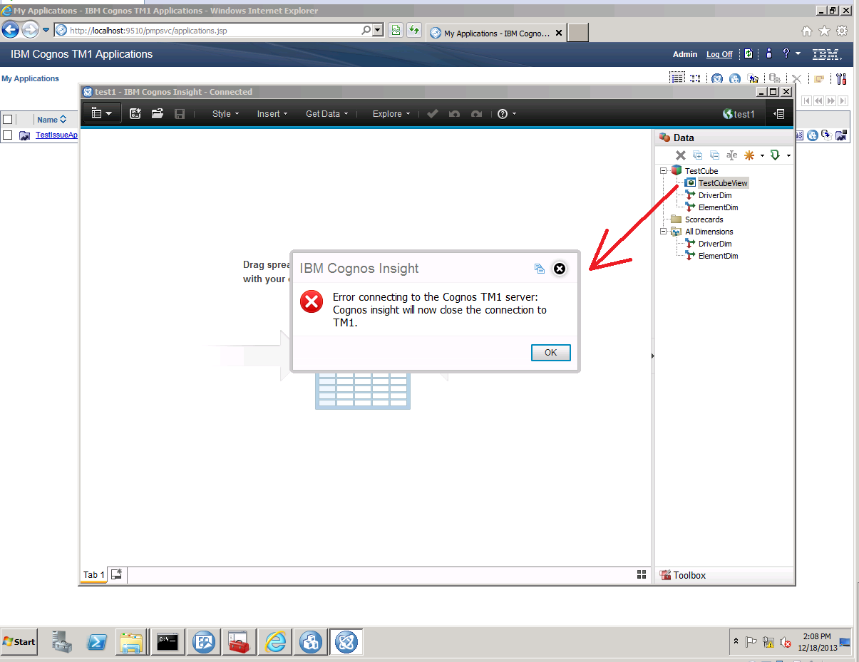

I got connected to the TM1 server, thaks for advice. But when I try to put a cube view to the workspace I got disconnected. Import data did not succeed too. I can't even google this error. =(
Error connecting to the Cognos TM1 server: Cognos Insight will now close the connection to TM1

The issue was caused by incorrect MDX that somehow passed to work in Architect, TM1Web, Contributor. I corrected it and finaly got Insight display my cube view.
