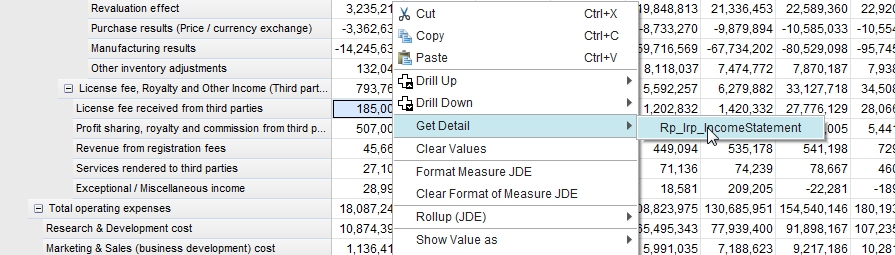

I have a TM1 model in TM1 10.2 FP1 with a relational drillthrough that perfectly works from all interfaces (Cube View, Excel DBRW, TM1 Web) but NOT from Cognos Insight. I can click on the correct drill string via Get Detail, but nothing happens...
I can see in the message log that the drillprocess was correctly executed but the RETURNSQLTABLEHANDLE did not result in the usual popup with the relational data.
Is this a bug? The feature seems to be present as I can click on the correct drill string...
Screenshot of the Relational Drill option in Cognos Insight

Relational drill through is not yet supported in Cognos Insight / TM1 Performance Modeler.
It requires client-side orchestration that is not there yet.
