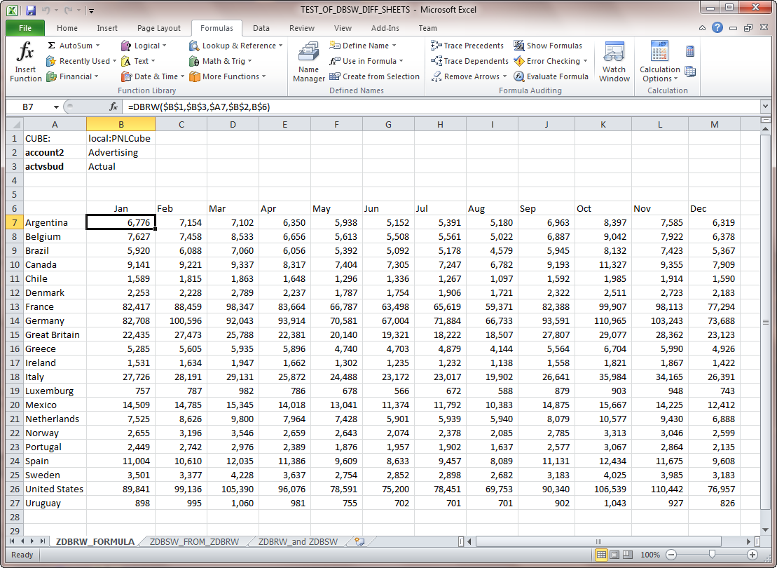

I have attached a workbook that makes use of the TM1 sample database named "PDATA"
I inserted an element in the actvsbud dimension named SendW01.
the workbook just pulls data from the Actual elements and attempts to send it to the SendW01 element.

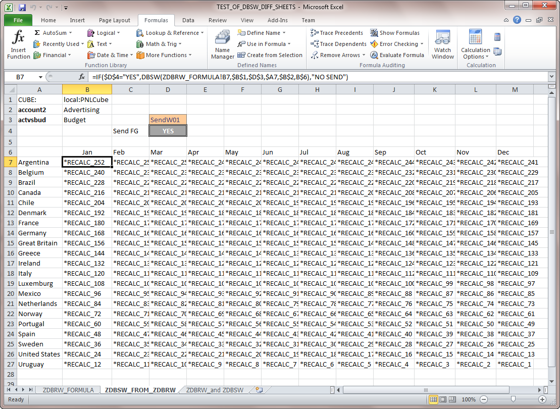

Have tried some of the suggestions:
1. have the DBRW and DBSW in the same sheet. - see sheet named "DBRW_and DBSW"
2. have a send flag
3. put the DBRWs and DBSWs on separate tabs, -- See sheets named STAGE and DBS_FROM_STAGE
- replace the DBRW references in the DBSW formula with Excel references to the DBRWs on the separate tab,
- refresh the DBRW tab,
- and then refresh the DBSW tab to load the data?
All of these method produce the same result because the DBSW formula depends on the DBRW formula

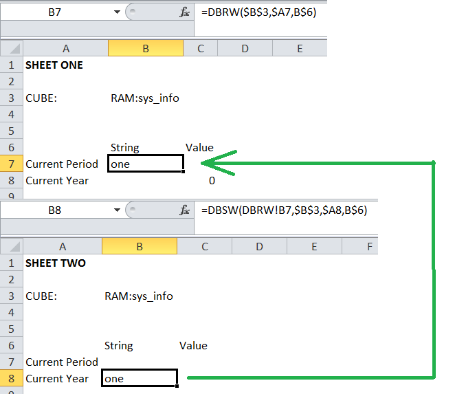

you_can't_have_a_DBSW_depend_on_a_DBRW (at least not on the same sheet). For that matter you can't have a DBRW depend on another DBRW either. This is pretty elementary TM1/Excel stuff and is to do with the way that the "W" formulas are calculated via batch, the client (Excel Perspectives) bundles all the DBRW/DBSW formulas into batches and requests the values from the server for the entire arrray of cell value queries in the batch. While the client is waiting for a response from the server all the values the waiting cells display an intermediate value of "RECALC". You can't send a value of "RECALC"to a numeric cell, nor is "RECALC" going to be a valid element ID if DBRWs are attempted to be used to supply address coordinates - hence your problem.
To make it work either the DBRWs need to be DBRs or the DBSWs need to be DBSs. (Since DBR and DBS are calculated one_by_one). However doing that will have some pretty dire performance implications in a large worksheet or workbook or any situation for use over a WAN.

In one worksheet, I pull data using DBRW
In the second worksheet, I use DBSW formula to send
Pressing SHIFT + F9 in the send Worksheet will only provide RECALC-###
