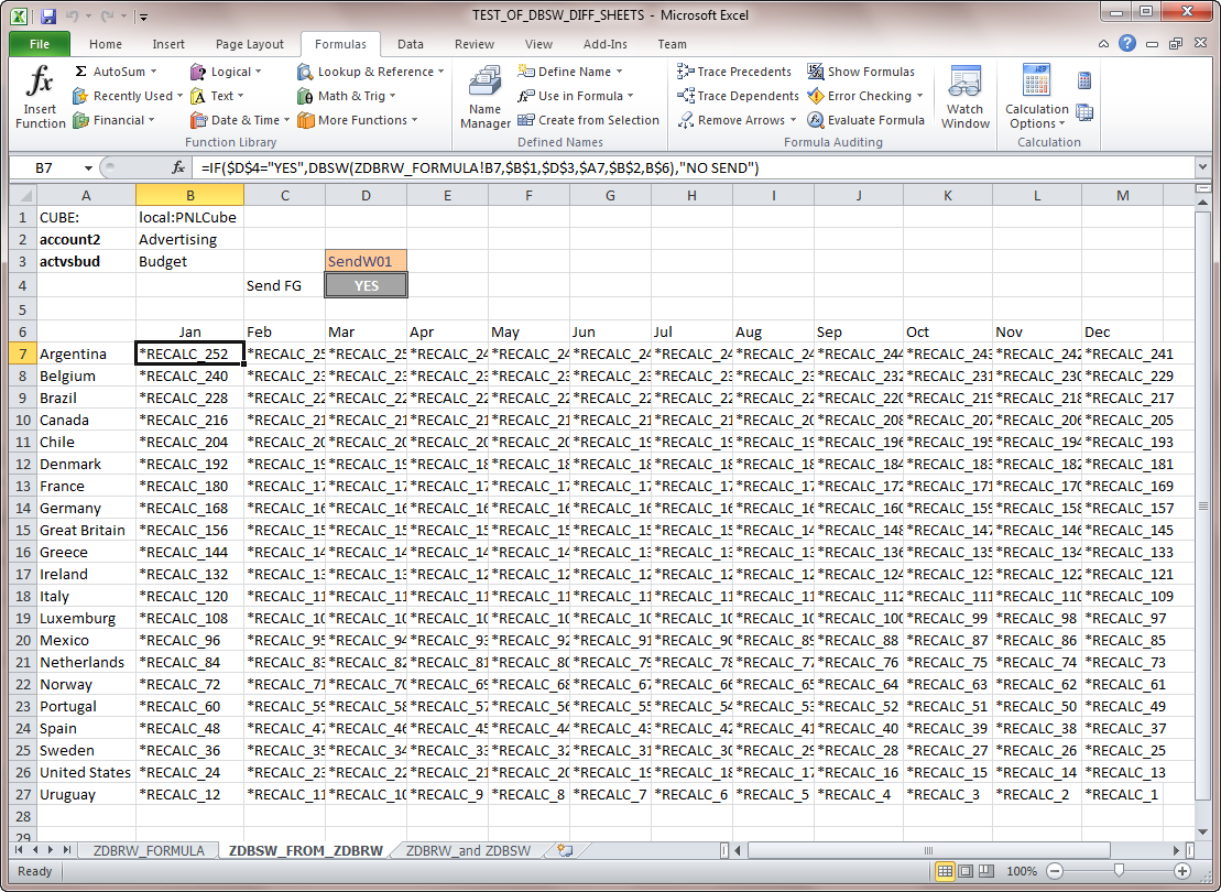

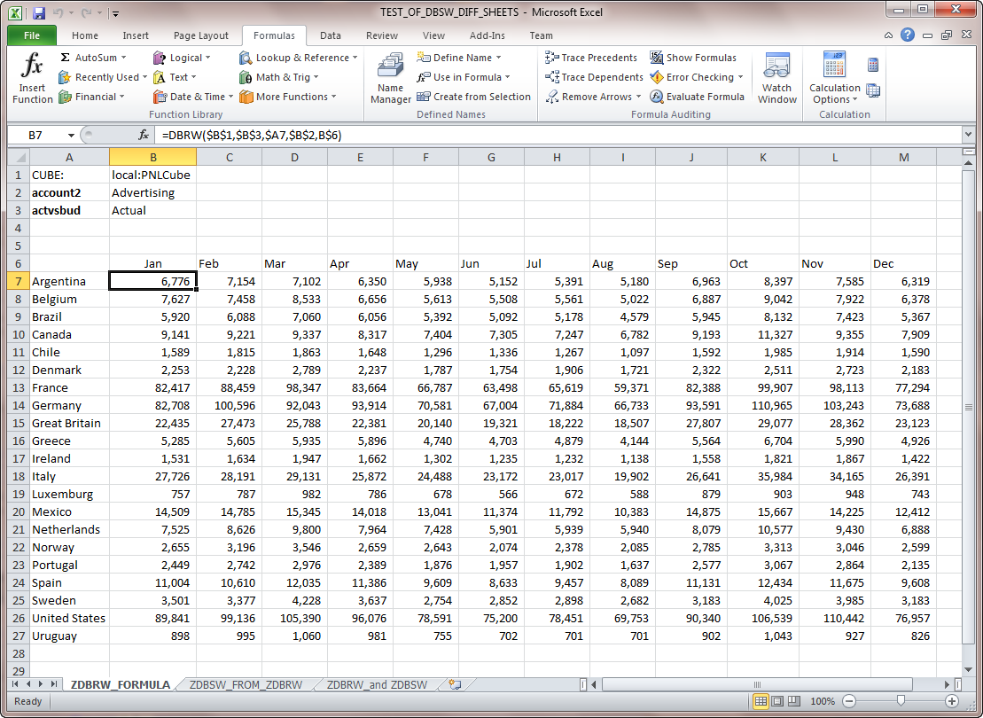

Folks,
I have attached a workbook that makes use of the TM1 sample database named "PDATA"
I inserted an element in the actvsbud dimension named SendW01.
the workbook just pulls data from the Actual elements and attempts to send it to the SendW01 element.
Have tried some of the suggestions:
1. have the DBRW and DBSW in the same sheet. - see sheet named "DBRW_and DBSW"
2. have a send flag
3. put the DBRWs and DBSWs on separate tabs, -- See sheets named STAGE and DBS_FROM_STAGE
- replace the DBRW references in the DBSW formula with Excel references to the DBRWs on the separate tab,
- refresh the DBRW tab,
- and then refresh the DBSW tab to load the data?
All of these method produce the same result because the DBSW formula depends on the DBRW formula
Does anyone use DBSW?
Walt

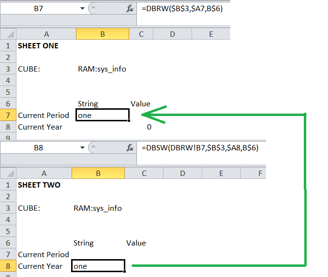

Re: How to Use DBSW
Walt,CiskoWalt wrote: ...
you_can't_have_a_DBSW_depend_on_a_DBRW (at least not on the same sheet). For that matter you can't have a DBRW depend on another DBRW either. This is pretty elementary TM1/Excel stuff and is to do with the way that the "W" formulas are calculated via batch, the client (Excel Perspectives) bundles all the DBRW/DBSW formulas into batches and requests the values from the server for the entire arrray of cell value queries in the batch. While the client is waiting for a response from the server all the values the waiting cells display an intermediate value of "RECALC". You can't send a value of "RECALC"to a numeric cell, nor is "RECALC" going to be a valid element ID if DBRWs are attempted to be used to supply address coordinates - hence your problem.
To make it work either the DBRWs need to be DBRs or the DBSWs need to be DBSs. (Since DBR and DBS are calculated one_by_one). However doing that will have some pretty dire performance implications in a large worksheet or workbook or any situation for use over a WAN.
It seems to me more a question of design. I see no reason WHY you would want to pull values from one cube with DBRW and send to another cube or section of the same cube with DBSW? This would be much more efficiently done with either TI (or rules if it is a permanent 1:1 relationship). Giving your users an action button with filter parameters of copy from / copy to would seem to be much more efficient if the data transfer is on as as needs basis.
Do people still use DBSW?
Sure.
Do DBSW formulas work and work efficiently?
Sure. (if they are set up correctly and used appropriately)
But I think DBSW is used to a much lesser degree than 10 years ago. For data input applications most folks have migrated to using TM1 web (or even TM1 Applications/Contributor) where there is no need for DBSW as values can be copy/pasted to a whole range of cells which was always the drawback in Excel. We also have TI now so any bulk movement or transformation of data is much better done using the right tool. For any new implementation in the last couple of years I would doubt DBSW has been used much if at all. Others may disagree but that has certainly been my experience.

Re: How to Use DBSW
Walt,
I've loaded a value using a DBSW that relies on a DBRW formula on a separate sheet. It requires that the sheets are not refreshed together.
- Shift + F9 the DBRW sheet, THEN,
- Shift + F9 the DBSW sheet.
So I'm curious as to why this doesn't work for you?

Re: How to Use DBSW
Thanks was on vacation for a few days.
I too am curious why this did not works for me.
In one worksheet, I pull data using DBRW
In the second worksheet, I use DBSW formula to send
Pressing SHIFT + F9 in the send Worksheet will only provide RECALC-###

- Posts: 1833
Re: How to Use DBSW
I recreated your cube as per shown in your attachment and it worked perfectly well when I pressed shift F9 on the Read tab and then moved to and pressed shift F9 on the send tab.
I receive the same errors you do if I just press F9 (without the shift i.e. a full recalc.)
A/ Are you positive that you pressed Shift + F9, not just F9?
B/ Is it possible that you have used hotkeys to manually assign Shift + F9 to something different so that the "tm1recalc1" doesn't initiate.
A possible way to test Shift + F9 operates correctly is by recording a macro then pressing it... from memory an F9 shows as "tm1recalc" and Shift + F9 shows as "tm1recalc1"... I tend to not do too much work in macros if it can be avoided though so my memory may be hazy if anyone wishes to correct me.
How to Use DBSW
Declan Rodger...THANK YOU !!!!!
The SNAG IT application mapped my SHIFT + F9 Keys to something else!!!
http://feedback.techsmith.com/techsmith ... t_f10_keys
Reason: Shift-F9 and Shift-F10 are hard-wired to video capture start & stop, which I never use. However, there are multiple applications in which I use Shift-F9 and Shift-F10 constantly. So I can't use those applications anymore when Snagit is working on my computer.

I just want to add my observations to this and to be honest looking for some reassurance! I would appreciate anyone who disagrees to please say so!
I am currently setting up some journal templates for the web. The contents of the template will end up in a holding cube and then be sent into the main cube via a TI process, so the users will click an Journal upload button on the web once the data has been sent to the holding cube.
I had the option to create an active form direct from the holding cube and allow the users to copy straight in, but I decided to go with creating an excel sheet with DBSW’s. The DBSW includes an if statement where the data will only be sent to the holding cube if:
• Each rows data is valid (based on lots of if and or logic etc in the excel sheet)
• Every row is valid (so no single row will be sent unless every row passes validation)
• Where the users has input Yes into a send data column.
So the formula on each row is:
=IF(AND($J9="Yes",$R9=1,$T$4="Valid"),DBSW(C9,$C$4,$C$5,$B9,C$8),"")
This formula extends across to a number of columns, so each column of data is captured and sent to the holding cube.
I believe in this case this approach is better because if I allowed users to input direct into the holding cube then I would have to add lots of process quit logic to the actual TI process which loads the data into the main cube and then I would have to return an error message on the web informing the users that the process failed for reason x, y or z. So the user would have to look at the data in the cube, figure out exactly what was wrong and retry to run the journal upload. Whereas using the DBSW allows the user to ensure all the data is correct before it ends up in TM1 and I think this is simpler for the end user, and means I don’t have to work out all the process quit logic in the TI and then deal with the consequence of the process quit. I think the DBSW will reduce data quality issues, whereas the alternatives will increase the likelihood of incorrect data passing to the main cube, and even if I added loads of logic to prevent data quality issues I think I would have to inconvenience the users to do this.
So I would say DBSW definitely still has its place in model design unless I have missed something?
cheers, Mark

I agree that DBSW still has a part to play - but with your testing logic I don't believe you will get the Stargate VIEW() performance win.
Given that you don't want any data to go unless your complicated tests are passed, I think you would be better off changing your cubename cell ($C$4) to be a formula which returns the cubename if all your tests are successful, and "" otherwise. The main DBSW would then be unconditional, but if the cubename is "" will do nothing. This will still deliver what you want.

Re: How to Use DBSW
Hi David,
big thanks for that.
I have updated my sheet to include the if statement in cell C4 and remove the if from the DBSW's as per your suggestion.
When doing that it suddenly occurred to me that I didn't need an if(and statement, just an if to say if $T$4="Valid", because cell $T$4 will only be valid if those other conditions are met! Too many if and or logics sending me crazy!
The only issue is that each DBSW cell now shows Key_Error, which is not a big issue as I was hiding those cells anyway.
cheers, Mark

I normally use something like:
C4 would have an expression to return True or False or just have a data validation. When TRUE, the DBSW is executed otherwise cells show "No Send". Works for me...and seems like it works for others too after reading right from the top.
=IF($C$4,DBSW(...),"No Send")-
