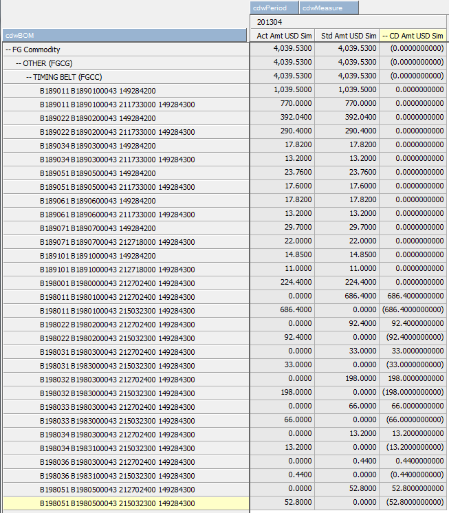

Whats wrong with TM1 displaying values like (0,000000000000)?
I have a natural consolidation [CD Amt], calculated using [Std Amt] - [Act Amt].
By calculating it manually, i get a value of 0.
But the natural consolidation gives a (0,0000000000) value as shown in the attachment.
I have checked that there is no rounding issues and the values added up indeed is 0.
May i know what else could be the problem here?

Cubeview screenshot
Cubeview screenshot
Natural Consolidation with exponential.gif (44.02 KiB) Viewed 21405 times

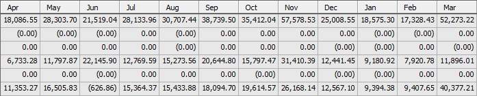

It really is annoying to get something like this with only 2 decimal point involve:
Data
Data
ScreenHunter_04 Jun. 12 12.38.gif (10.96 KiB) Viewed 21141 times
look at all the (0.00)...
