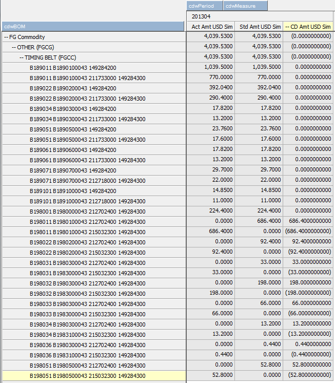

Whats wrong with TM1 displaying values like (0,000000000000)?
I have a natural consolidation [CD Amt], calculated using [Std Amt] - [Act Amt].
By calculating it manually, i get a value of 0.
But the natural consolidation gives a (0,0000000000) value as shown in the attachment.
I have checked that there is no rounding issues and the values added up indeed is 0.
May i know what else could be the problem here?

So in summary, it is not possible to get a zero, unless using the "safe divide" method in the rule itself?

conray
Posts: 41
Joined: Thu Jul 07, 2011 7:50 am
Version: 9.5.2
Excel Version: Excel 2010
Re: Exponential Problem with Natural Consolidation
Post by conray »
ioscat wrote:Possibly yes and possibly no
Depends on
depends on what?
It really is annoying to get something like this with only 2 decimal point involve:
Data
Data
ScreenHunter_04 Jun. 12 12.38.gif (10.96 KiB) Viewed 21110 times
look at all the (0.00)...
