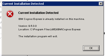

we have ibm cognos express 9.5 installed. Could be the installation process differ from the enterprise edition? Run as administrator doesn't work ...
Tm1 Install Error.png (4.93 KiB) Viewed 4266 times

clubjoker wrote:we have ibm cognos express 9.5 installed.
Don't you think that would have been relevant information to include in your original post? I'm pretty sure the ability to link TM1 with other systems (via the OLEDB for OLAP driver) is not part of the Cognos Express licensing. That might explain why it isn't included, perhaps others will know for sure (I've never implemented CE).
