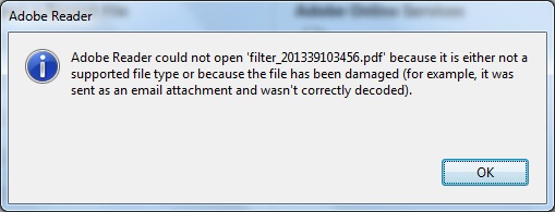

Now i am able to Export the cube view to PDF but i am getting another error after exporting to PDF while opening the PDF File
Following is the Snapshot for the same
PDF Camp After Print error
PDF Camp after Print Error.jpg (29.24 KiB) Viewed 5867 times
Following are the System Configuration
1. TM1 10.1.1
2. Adobe Reader 10
Do let me know for the same

Thanks a lot All the Errors Solved

Hi Amit,
I've got the same error message "adobe reader could not open <FileName>.pdf", can you please post the solutions how you resolved the issue that will be really helpful.
