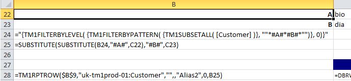

I tend to build the MDX statement in a seperate cell which I the reference from the TM1RPTROW function as shown below:-
This seems to work OK for me.
Re: MDX Wildcards in Active Forms
Posted: Tue Feb 19, 2013 4:25 pm
by AmbPin
so a simple dynamic version might look like this:-
