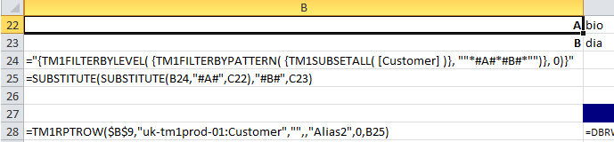

Is this the sort of thing you are looking for?

I tend to build the MDX statement in a seperate cell which I the reference from the TM1RPTROW function as shown below:-
This seems to work OK for me.

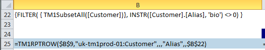

Re: MDX Wildcards in Active Forms
Post by AmbPin »
so a simple dynamic version might look like this:-
