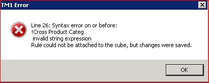

Hi I tried to write a rule like,
[target]=N:DB(cubename,dim1,dim2...dim7)*DB(cubename,dim1,dim2...dim11)*DB(cubename,dim1,dim2..dim11)\100;
My request is how make a particular dimension dynamice in the DB function instead of hardcoding.
please suggest me.
Is the error comes for mismatching of dimensions. In this case how to make non matching dimensions dynamic.
Please find the attachment for the error message.
TM1 9.5.2
Excel 2007.
Thank you

My exact question is in the rule for a dimension where I am getting error like "invalid synstax error" if i select single element in this particular dimension then I am not getting this error but it is hardcoding, please help me how to make this rule dynamic.
Thank you.

The error is probably generated because you make a !dim type of reference to a dimension that is not part of the destination cube. You can use this type of reference only for the dimensions that are part of the destination cube (which makes sense if you think about it). For all dimensions referenced that are not part of the destination cube you need to come up with "somethinge else", depending on your exact requirements. This could be selecting a single element in these dimensions or use attributes or mapping cubes to derive the required selections.charan wrote:Any suggestions please.
