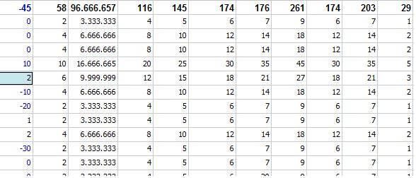

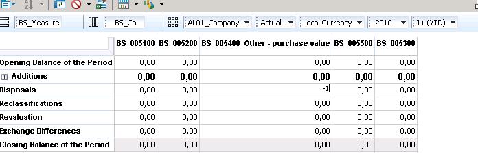

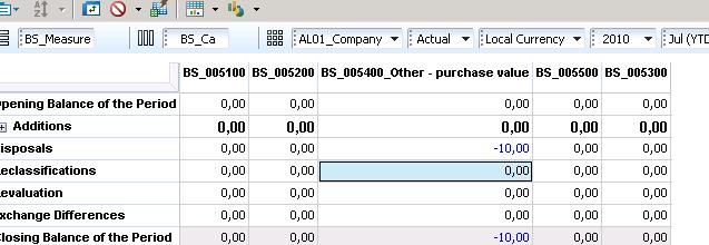

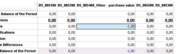

when i put number
result
1*-1 In general when is in firts place - or + result is -10, or +10
result
