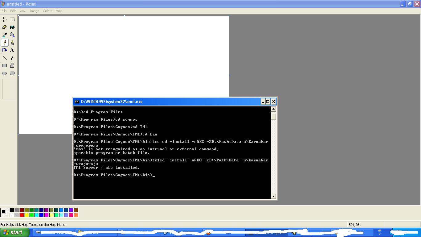

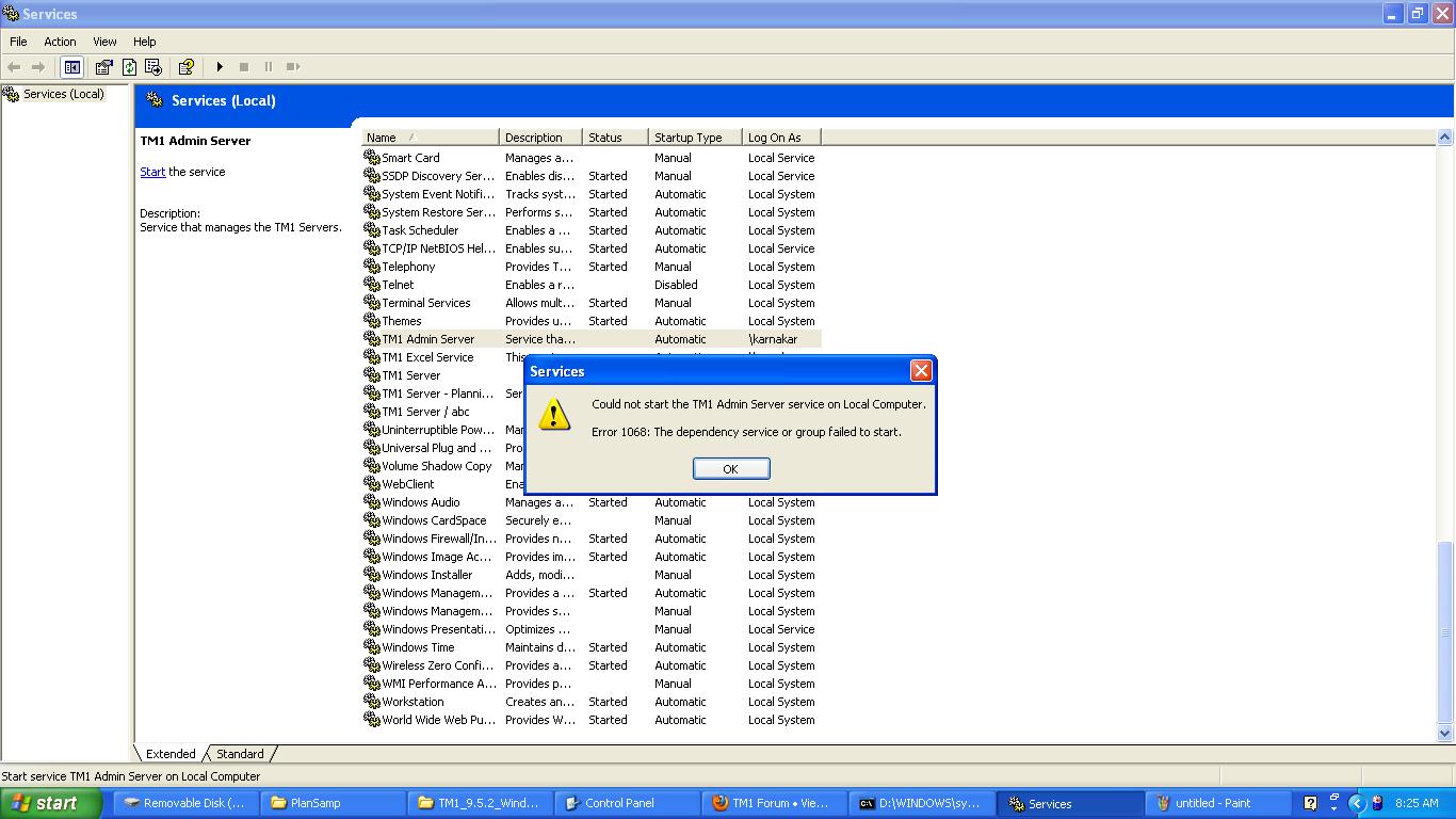

I am getting an error 1608, through our forum i got information to resolve that, I tried that. Still the admin server is not running.
But here I am missing a step, please can anyone rectify it. Please find the screen shots for it,

I'm not sure why the Admin Server service would be saying that "the dependency service or group" failed to start because it doesn't depend on any other system components, as the Dependencies tab should show. (The servers on that box do depend on it, but that shouldn't prevent the Admin Server from starting. I'm assuming from your screenshot that you were trying to load that one rather than one of the servers.)
However... I do note in your screenshot (thanks for adding one of those, a picture may well be worth the proverbial thousand words here) that you installed the server service using the user name \Karnaker. And judging from the seeming lack of a period in front of the Log On As entry for the Admin Server, it looks like you may have done the same thing there.
If I recall correctly the standard installation package warns that you may encounter problems if you don't enter the user name in the format:
DomainName\UserName
or
MachineName\UserName
as the case may be.
This may well be an example of that.
Try uninstalling and when you reinstall, make sure that you add either the domain or machine name ahead of your user ID and see whether that works.
