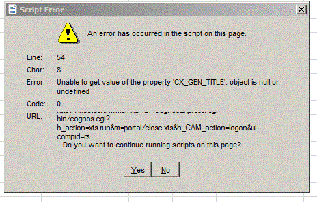

Going to: http://<servername>/IBMCognosExpress/cgi-bin/cognos.cgi?b_action=xts.run&m=portal/close.xts&h_CAM_action=logon&ui.compid=rs
I get the error
Script Error
Script Error
Microsoft Excel - Book1 - Remote_2012-08-24_17-09-36.gif (37.39 KiB) Viewed 4431 times
It works if I click yes.

So I have ended up:
Disable Internet Explorer script error debugging, by performing the following on the client device:
1. Launch 'Internet Explorer'
2. In the top menu, click 'Tools' and then 'Internet Options'
3. Click on the 'Advanced' tab
4. Locate the section 'Browsing'
5. Locate the option “Disable Script Debugging” and tick the box beside it
6. Locate the option “Display a notification about every script error” and untick the box beside it.
As per http://www-01.ibm.com/support/docview.w ... wg21432490
I feel dirty inside :oops:
Anyone else think/know of a better soultion?
