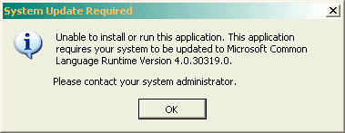

I get the following error when I try to install the Flow Model Packager:
"Unable to install the application. The application requires that assembly XmlDiffPatch Version 1.0.8.28 be installed in the Global Assembly Cache (GAC) first."

I should have stated, the tools require the latest .NET framework (version 4) to be installed on the target machine. These are primarily development tools, so I would recommend installing on your personal laptop or desktop before trying in any corporate environment.
You can get the .NET framework here.
There is also a dependency on the XmlDiffPatch component from Microsoft, although I wasn't aware it would need to be separately installed. You can find a download link here, at the top of the article.
For those of you who cannot install due to not having admin rights, this should be no issue. The install is per-user, so you only need rights to your own user profile. This is, of course, in theory, so I'm curious to hear about your individual experiences.
I chose this deployment model because I want to be able to update the tools frequently, at least in the early stages, and will need to release patches. Hence, internet access on the target computer is also a requirement, at least for now.

I'm curious about this error: "Unable to install the application. The application requires that assembly XmlDiffPatch Version 1.0.8.28 be installed in the Global Assembly Cache (GAC) first."
Firstly, has anyone installed successfully without getting this message?
Secondly, for those who do, can you give me some information about the OS you're installing on?
I tried it on my desktop machine here, which has never had XmlDiffPatch installed, and it ran successfully, so perhaps it's OS specific?

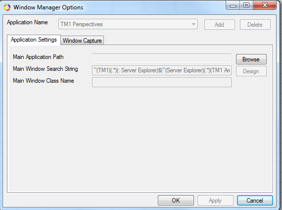

A few things on the Windows Manager.

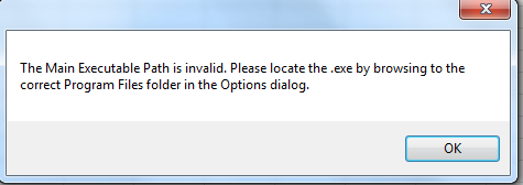

When I start it I get this error:
and after pressing OK this screen (which doesn't seem to have any user-configurable options?)
and after pressing OK gives me the Windows Manager screen which works fine.
TM1 9.5.2 and Windows 7.

Posted: Fri Jul 27, 2012 9:13 pm
by Harvey
Hi all, thanks for trying out the tools. I'll try to deal with all your queries in this post.
1) Flow Window Manager. When you begin, the program starts by asking you for the "Main Executable Program". This is actually asking for the path to tm1a.exe. You have to click the Browse button next to the first textbox labelled "Main Executable Program", browse to the TM1 bin folder, and select tm1a.exe.
2) The reason this is a bit ambiguous, and that there are greyed out options in the settings screen, is that the Window Manager was designed to work with any program. For example, I actually used to use it with Microsoft Messenger years ago, when I used to chat to lots of people while procrastinating doing my real work! For this release, I simply included the TM1 configuration and removed all the options to keep it simple.

Hi Harvey - I have noticed some, dare I say it, bugs in the window manager.
- Subset Editor: windows aren't collected
- TM1 Security Assignments: windows aren't collected
- Clients/Groups: window isn't collected
- (Advanced) Rules Editor: the horizontal and vertical scroll bars are all screwy and don't work (although mouse wheel does) and if there is another window pinned on whatever side of a rules editor tab the window doesn't re-adjust the R, L, T, B etc. it just seems to orient from top left of the window manager container as a whole
Also - how to make it work without the path to tm1a.exe? I usually work with Perspectives not Architect and it is annoying that architect launches with the window manager. Why not be able to select tm1p.xla as the root application (or why need this setting at all since all that seems to matter is the captions of the windows themselves?)
Enhancements?

lotsaram wrote:I have noticed some, dare I say it, bugs in the window manager.
Those Windows were left out on purpose, but I suppose that's just personal preference. For instance, I didn't like it when I double-clicked a dimension in a cubeview and had the resulting subset window dock -- and I couldn't figure out a way to determine how the window had been launched to treat the two cases differently.
However, your suggestion below of allowing the user to select particular window type is a good one, and will allow me to keep us both happy!
I do not use the advanced rule editor, but I do recall it having some strange quirks when I looked at it. It actually seems to render in some non-standard ways and does not behave well as a regular window. I will fire it up and see if there's anything I can do.
lotsaram wrote: Also - how to make it work without the path to tm1a.exe? I usually work with Perspectives not Architect and it is annoying that architect launches with the window manager. Why not be able to select tm1p.xla as the root application (or why need this setting at all since all that seems to matter is the captions of the windows themselves?)
Yes, this is a known bug at the moment. I am fixing this so that if you start Window Manager when Perspectives is loaded, it will suck that window in instead of starting up a new instance of architect.

Love both the Server Manager and the Window Manager. It is a GREAT addition!! Though there are some bugs as a first release I believe you really do have something special.
I am struggling to install the Flow Model Packager.
I have installed .Net FM 4 and I know I have to download\install XMldiffPatch, the download location does not work:
I have tried searching the web for the XmlDiffPatch but all I am getting are registry cleaners :)
Any other locations you know of?

Hi Mems,
Thanks, glad you like the tools.
Yeah, it seems that link seems to has died, thanks for the heads up!
I was able to locate a new one here, but if that fails in the future, you can also now download it from the flowolap.com site.
It's also worth noting that I will be releasing a new version of the Model Packager, which will be the official beta version, early next week. This one should not have the dependency on XmlDiffPatch, and will be fully functional for partners who have signed up on our site.
Let me know if this doesn't get you over the line, and I'll find an alternative way to get the file to you.
