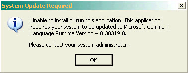

I get the following error when I try to install the Flow Model Packager:
"Unable to install the application. The application requires that assembly XmlDiffPatch Version 1.0.8.28 be installed in the Global Assembly Cache (GAC) first."
Paul
Re: Free TM1 tools available now
Hi Harvey - nice! Or at least I suppose it would be nice, but I concur wholeheartedly with Steve. You need to provide a fully packaged installer. In a corporate environment servers are locked down and fire-walled and connecting to the internet to pull down the full installation is a no go.
I also get the following and progress no further which I guess is an artifact of corporate Windows environments being behind the times (my work station runs XP and our servers are W2003) But that's a fact of life and something you have to bear in mind if designing a product for a corporate market.

Apologies for the installation problems.
I should have stated, the tools require the latest .NET framework (version 4) to be installed on the target machine. These are primarily development tools, so I would recommend installing on your personal laptop or desktop before trying in any corporate environment.
You can get the .NET framework here.
There is also a dependency on the XmlDiffPatch component from Microsoft, although I wasn't aware it would need to be separately installed. You can find a download link here, at the top of the article.
For those of you who cannot install due to not having admin rights, this should be no issue. The install is per-user, so you only need rights to your own user profile. This is, of course, in theory, so I'm curious to hear about your individual experiences.
I chose this deployment model because I want to be able to update the tools frequently, at least in the early stages, and will need to release patches. Hence, internet access on the target computer is also a requirement, at least for now.
If any of you would like to get personal support, send me a personal message via this board (preferably with your email address, so we can use regular email) and I'll try to assist you with your installation issues.

I'm curious about this error: "Unable to install the application. The application requires that assembly XmlDiffPatch Version 1.0.8.28 be installed in the Global Assembly Cache (GAC) first."
Firstly, has anyone installed successfully without getting this message?
Secondly, for those who do, can you give me some information about the OS you're installing on?
I tried it on my desktop machine here, which has never had XmlDiffPatch installed, and it ran successfully, so perhaps it's OS specific?

On the XmlDiff error, I was running XP SP3.
Loading .Net and the patch fixed the error, and the Window Manager now works (and it looks very good, most useful).

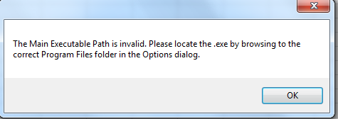

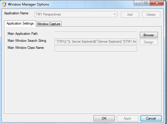

A few things on the Windows Manager.
When I start it I get this error:
and after pressing OK this screen (which doesn't seem to have any user-configurable options?)
and after pressing OK gives me the Windows Manager screen which works fine.
TM1 9.5.2 and Windows 7.

OK. After installing the .Net 4 framework I can run the rest of the install process for 2 out of the 3 apps.
I get all the same errors on initial launch of window manager as Paul, but then the application works fine (except for the window menu dropdown being as Paul described with just blank rows one of then with a tick).
As for the window manager itself, I like it, in fact I like it a lot. Except that the windows only seem dockable with no floating option. I think it's essential to be able to pop a window or tab out and float it as sometimes for the sake of screen real estate or just juggling multiple windows that can still be the best way to manage multiple views, rule tracer etc and see the whole picture. I don't know whether it is programmatically possible but an option to "disolve" the window manager and release the windows back to "standard" perspectives or architect configuration and a "re-gather" option would be a nice little addition.
I haven't tried the server manager yet other than to verify that I can launch it but to me it seems that unless I can install and run on a server then what is the practical use unless you're in pre-sales and prone to setting up lots of servers on your laptop.
The model packager install fails with the error already mentioned "Unable to install the application. The application requires that assembly XmlDiffPatch Version 1.0.8.28 be installed in the Global Assembly Cache (GAC) first."

Hi all, thanks for trying out the tools. I'll try to deal with all your queries in this post.
1) Flow Window Manager. When you begin, the program starts by asking you for the "Main Executable Program". This is actually asking for the path to tm1a.exe. You have to click the Browse button next to the first textbox labelled "Main Executable Program", browse to the TM1 bin folder, and select tm1a.exe.
2) The reason this is a bit ambiguous, and that there are greyed out options in the settings screen, is that the Window Manager was designed to work with any program. For example, I actually used to use it with Microsoft Messenger years ago, when I used to chat to lots of people while procrastinating doing my real work! For this release, I simply included the TM1 configuration and removed all the options to keep it simple.

7) If you install the .NET Framework and the XmlDiffPatch tool, the Model Packager should run. If anyone is able to install these prerequisites and it still won't install correctly, please let me know.
