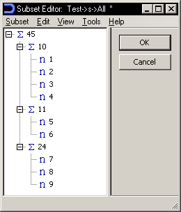

The dimension structure is
Dimension structure
Dimension structure

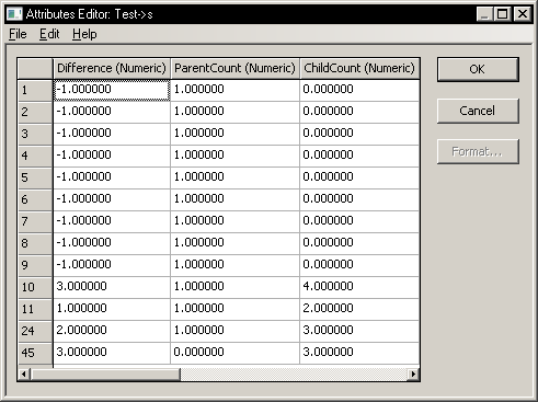

and the resulting attribute values are
Calculated attribute values
