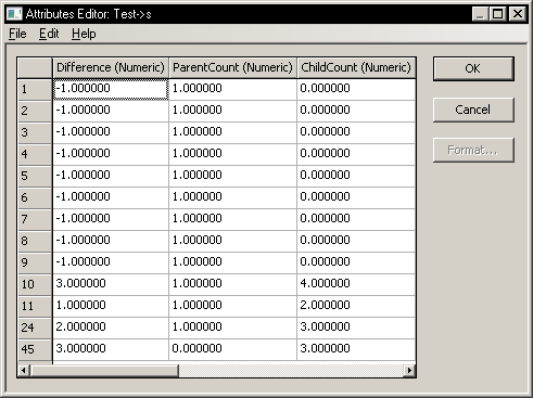

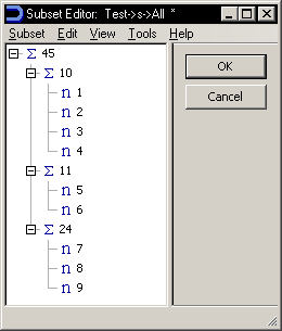

An attribute cube, no matter what the type of the attributes, behaves as if all elements are of type text. This is what allows numeric attributes to be entered for consolidated items. It is perfectly possible to write a rule for a numeric attribute but you have to treat it as a string, and the result of the rule statement needs to be either the empty string, or the text representation of a valid number.
To illustrate I added three numeric attributes (ChildCount, ParentCount and Difference) and the following rule to the attribute cube for a simple dimension s.
['ChildCount'] = S: TRIM(STR(ELCOMPN('s',!s),16,0));
['ParentCount'] = S: TRIM(STR(ELPARN('s',!s),16,0));
['Difference'] = S: TRIM(STR(NUMBR(DB('}ElementAttributes_s', !s, 'ChildCount'))-NUMBR(DB('}ElementAttributes_s', !s, 'ParentCount')),16,0));
The dimension structure is
Dimension structure
Dimension structure
and the resulting attribute values are
Calculated attribute values
Re: }ElementAttributes_Dept N:numeric attribute not working
Duncan P wrote:This documentation is not entirely accurate.
Duncan, that's a fantastic piece of TM1 rules gymnastics! Where there is a will there is usually a way.
