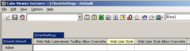

Does anyone know how to set tm1web not to show the sandbox?
there was a hide websheet toolbar in }ClientSettings but users need the other functions like slice and recalc.
and what this setting means; user style, allow overwrite ?
Thanks!

Re: Hide Sandbox - TM1Web
TM1 now has the Cognos permission sets within the capabilities area, which is a bit confusing as I am unsure whther it is utilised yet.
I have allowed sandboxing by group through the capability assignments before, but I find it easier (at least to get started with what IBm does with the setting) to go to the server root, right click , select capabilities (this opens your cube you have a screenshot of but in a certain format), then grant or deny access ... then once you have done a few, go back to the control cube }Capabilities and see how it is managing this.
Dont think you can have the global setting = T AND the capability assignments working at same time. Global setting would be the dominant setting?
you're right! 'Deny' a security group in 'capabilities' disables sandbox for users in that group
when DisableSandboxing=F or omitted in tm1s.cfg, but Admin group can't be denied access
even when "use sandbox" capabilities are denied. (had integrated login so had to test using
someone else's machine)
