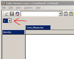

I really do look for answers before bothering folks on a list like this. I'm sorry to say I'm stuck again. I can see the alias name when I view my dimension in the dimension editor, (if I use the Alias toolbar to display them, or even though I click through the Edit/Select Alias... pick my alias and say OK.)
But how do I cause that dimension name to appear by default whenever I see that dimension in a cube or elsewhere?
The first cube I built, shows the dimension element numeric value and not the nifty alias name.
Thank you for any advice. A reference to a section in a manual or book would be fine also.

One thing in your screen shot which I have noticed that your element name is 1. (with the dot)
In your case the best practice is to create the element names without the dot so that your element is 1 not 1.
