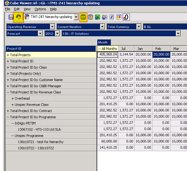

Just wondering if my double entry is really caused but the users not reloading the view rather than simply choosing the refresh button
tm1-test -_2012-04-26_Refressh.png (29.87 KiB) Viewed 4147 times
I have noticed in testing that I get double entries in the hierarchy if I don't choose reload. Even commented out my TI process and it seems to be okay.
