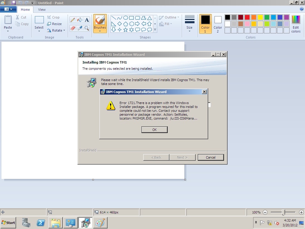

I have done it by selecting the custom, and error i get is please see the attached.
I have done the needs to be done for the error 1721.But still same

- Posts: 6672
Re: Not able to see the services running for tm1 in 2008 R2
Check out the following technote on the Iboglix web site:viswaraju wrote:Dear Alan,
thank you.
I have reinstalled it once again.
I have no MS Office installed, in my set up.
http://www-01.ibm.com/support/docview.w ... wg21444215

IBM technote wrote:--> In case this does not work, do the following :
In Windows Server 2008 by using the Server Manager tool :
-Click Start, click Administrative Tools, and then click Server Manager.
-In the navigation pane, expand Roles, right-click Web Server (IIS), and then click Add Role Services.
-In the Select Role Services pane, scroll down to IIS 6 Management Compatibility.
-Click to select the IIS 6 Metabase Compatibility and IIS 6 Management Console check boxes.
-In the Select Role Services pane, click Next, and then click Install at the Confirm Installations Selections pane.
-Click Close to exit the Add Role Services wizard.

thank you.The steps you have given is done and after that i have started my installation has run as administrator and it was installed.
