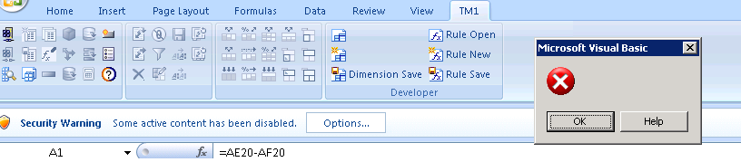

I am using CE 9.0 and the data sitting in the excel is using active forms. After opening the excel, when i try connecting to TM1 server, it gives me Mirosoft Visual basic error. Has anyone faces this issue before ?

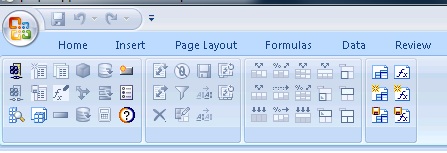

As i press ok, the title on the tool bar (TM1) starts disappearing. At the end the title will appear again. I have been trying a number of ways to replicate the error or to get it working.
Those ways I have tried including
1) openning the excel active form document, load prespective and connect to TM1 ( all the time doesnt work)
2) load prespective, connect to tm1 and opening the excel active form document. ( sometimes work and sometimes not)
and the worse is testing on different machine gives me different result. what have i done wrong ?

Re: Mirosoft Visual Basic Error
This is a common issue, and from my experience affects different machines at different times, even if they are supposedly built from the same image.
Your two choices are to either switch away from the TM1 tab on the ribbon, which you will forget to do at some point and the issue will re-occur, or rename the TM1pRibbonX.xlam file in which case the old fashioned pre-ribbon menu system will appear in its place, if I remember correctly, under the Addins tab.
This appears to be one of the issues they have fixed in 9.5.2 FP1. Which doesn't help you if you are on CX9.0.

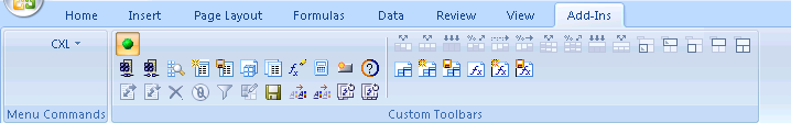

Is this the one you referring to ? by default the add-ins menu only has icon and there isnt any name for it ?
Yes that is the menu.
You can rename the tm1pRibbon to whatever you want. It is simply a means of making Perspectives unable to find, and therefore load, the file. If it can't find it you get the menu in your post.
Yes you don't get descriptions with the icons, it is a pre-ribbon menu system. You can use the drop down menu on the CXL item on the left hand side of the menu bar, which has textual menu items.
As for switching away from the TM1 Ribbon tab, yes you have to have it selected when you actually want to do anything with TM1 - which is why I was saying that at some point you will forget to switch away from it.
