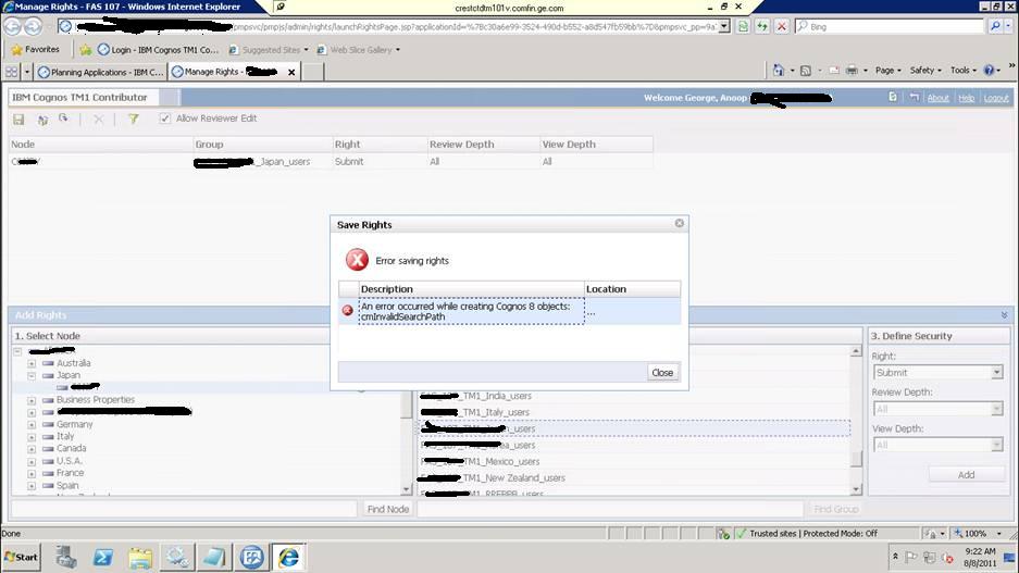

Hi ,
When we are trying to save the security rights which we have defined in contributor, we are getting the error message “ Error occurred while creating Cognos 8 Object: cmInavlidSearchPath”
We are using TM1 9.5.2 , Cognos 8.4.1 integrated security mode =5. Please find the error message below.
Contributor error 2.JPG (61.52 KiB) Viewed 4487 times

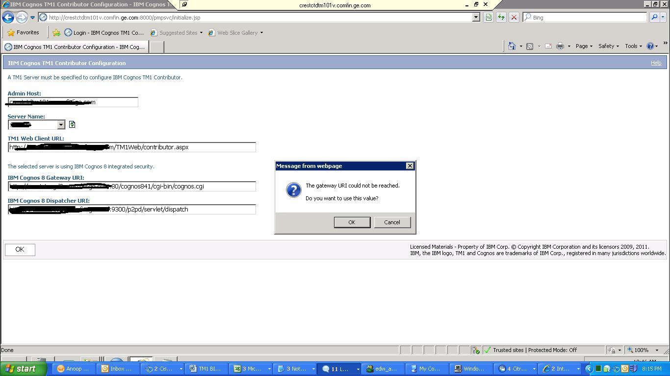

We got a warning when intializing the contributor for the first time. The message was "Gate way URI could not be reached. Do you want to use this value?" (Screenshot below)
Contributor error.JPG (116.07 KiB) Viewed 4487 times

I got this recently. It was the "}TM1_DefaultDisplayValue" attribute in the }Groups dimension. They have to be prefixed with where they come from. I was running Express so it had to be Cognos\{Object}. Not sure if it'll be the same with enterprise software, but I should imagine that's a good place to start.
You might find, as I did, that one of them works and has the prefix already there. Just copy that one.
Martin

Hi Martin ,
Thank you so much... It worked !!!!!!!!!
I was stuck with this error for the last 2 days. The error log also didnt show any error message for this.
