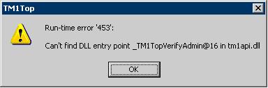

When I copy these 3 files from applix\bin to the tm1top folder, tm1top works but veryfiy still does not work and I receive the error message below.

I am still having problems with TM1Top in version 9.0. I am able to monitor and but not able to verify and kill procceses or disconnect users.
Is there any other way in TM1 to kill hanging user requests or to disconnect hanging users?
Any help will be highly appreciated.

Here is the response frm IBoglix;
Unfortunately, TM1TOP is not compatible with 9.0.1. The first fully compatible release is 9.0.2.
