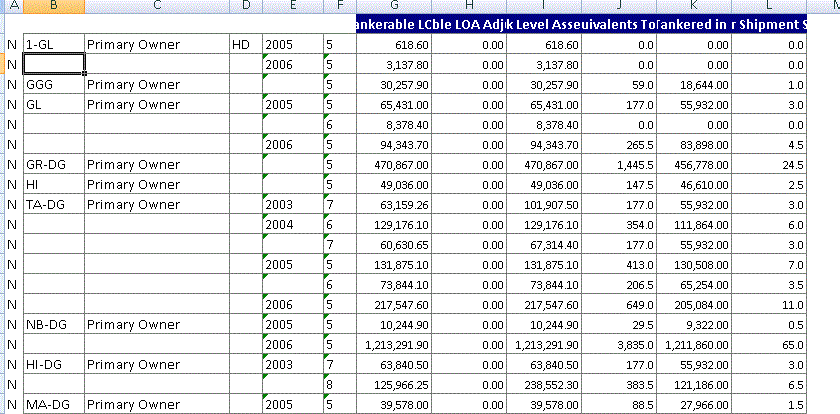

Hello everyone,
I was wondering if anyone had any experience or knowledge of the following:
If one creates an active form of say, 5 stacked dimensions of row, at leaf level with no consolidations an active form, by default, will create the effect of the following:
By default, for the first 4 stacked dims TM1 will format (somehow) the text as the same colour as the background until a new element is found (i.e. GGG in Dim 1), i.e. appearing blank (i have marked and example by selecting a cell).
This is not defined in the format area, and in this example as there is no consolidations every row is a N level format area.
I was wondering if anyone one knows how/where TM1 is defining that cell font colours should match their background in the leading dimension rows until a new element value appears?
Jack
This is clearly not defined in the format area, if you click in the cell

Hey Dan,
Thanks for the response.
All the rows in this example are N level, as you can see from the values in column A.
Because the active form has stacked dimensions, when TM1 builds the active form formats the cell in column B after the first row differently to the first. If one selects the cell (as in the example), Excel knows that the value is "1-GL" it's just been formatted to be "hidden" until the next leaf element appears in the active form (i.e. in the example "GGG").
According to the format area definition in column A, there is no difference between these cells, so I was just wondering if anyone knew how TM1 active forms created this "additional" level of formatting.
Rebuilding the sheet does not change this, it's how it appears when it's first built anyway.
Jack

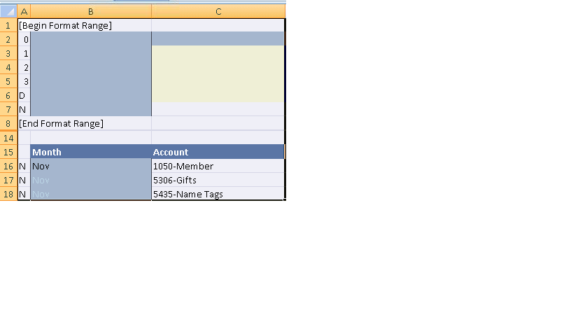

I'm trying to implement the repetition of the member names too.
However, I did not get how to implement the formula.
Could anyone please help?
Do I need to write =B6 in the Cell B7? I don't think that works.
active form.png (12.27 KiB) Viewed 12729 times
Re: Active Forms Stacked Dimensions Formatting
TM1KS wrote:Hi Everyone,
Go back and re-read the post from TomBr properly. The formula is in the conditional format NOT in the cell!
