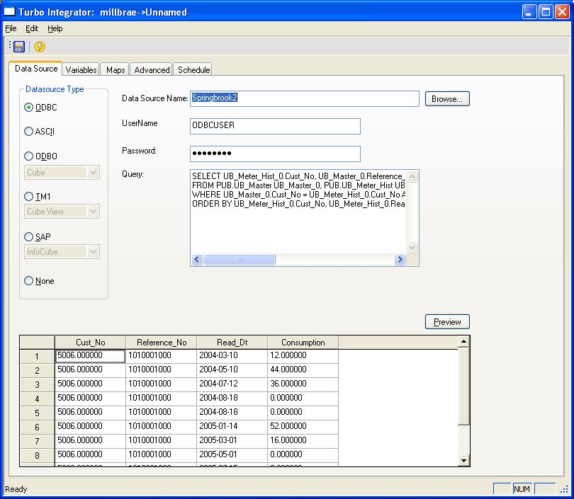

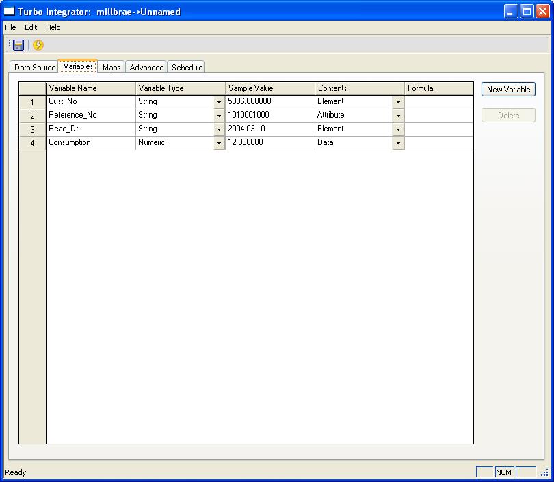

I'm trying to figure out if I can use TM1 to create a cube that would store irrigation meter readings. There would only be 2 dims- Customer Number and Meter Reading Date, with the usage/consumption as the data. Is there a way to create another data variable that would calculate the difference between read dates for each account/customer number? I have attached a few screen shots of the TI process:

There are various ways to do this. The basic function that you need is DAYNO. This gives a serial date number for each date. From the Help DAYNO('98-03-09') returns 13947. You can find this in the Help under Date and Time Rules Functions.
The difference between the DAYNO of the current and previous meter reading will give you the number of days between the readings.
However, the bigger problem is how you identify the previous reading.
One option would be to replace your date dimension with one that just had a list of sequential numbers, eg Slot 1..Slot200.
Then add a measures dimension to hold the meter reading and the date that it was read, which could be stored as a TM1 DAYNO date serial, or as a Text Date. You could also add elements for the days since last reading and units consumed.
You could then have a numeric attribute on the customer dimension to record the number of readings taken for that customer.
As you loaded data, you would retrieve the number of readings taken, and add 1 to this, which would give you the slot in to which you needed to put the data.
You would then load the data in to this slot, and update the number of readings taken. You would then easily be able to reference the previous slot and use CellGetN to retrieve the previous readings. You could then calculate the number of days since the previous reading and the units consumed, and store those in the cube. You could then calculate the units consumed per day.
As an alternative you could stay with your date dimension scheme, which you might want in order to allow consolidation, (although you could also use the previous cube to feed a more consolidated view, by taking the movements, eg days between readings and units consumed and consolidating them to a monthly level by customer group).
If you did stay with your date dimension scheme then you will need a way to access the previous reading.
One approach would be to use rules to roll forward the values of date read and meter reading, until interrupted by an entry. You could use a rule along the following lines Result = IF( Input <> 0 then Input else Result from previous day). This sort of scheme is OK in some cases, but the feeding it requires can cause an explosion in memory requirements if used with a detailed dimension containing individual customer.
Instead I would recommend an approach that was similar to the number of readings taken attribute. Assuming that these are domestic customers and you would only ever take at most one reading on any one day, then you could store the date last read as an attribute on the customer dimension. Then when loading data you would get the attribute for the previous date. You could then use that to access the previous meter reading as well. Doing the DAYNO(This Date) - DAYNO(Last Date) would give you the number of days between the readings, and subtracting the meter readings would give you the consumption. I would recommend adding a measures dimension to your cube to allow the days and units to be stored, as well as calculating the average consumption per day.

PaulSimon wrote: One option would be to replace your date dimension with one that just had a list of sequential numbers, eg Slot 1..Slot200.
- If I understand this correctly, I'll need to create a lookup cube with only one dimension that has a sequence of numbers. I'll use CELLGETN in the TI process of the meter readings cube to load the data into this "slot" dimension i.e. "slot='Slot' | CELLGETN('lookupcubename','slotno'); Is that basically the idea?
- If I understand this correctly, then I would need to set up measures as a consolidated element (as it would be holding the meter reading elment and the date element?). In order to determine what the "last reading" was, would I use the highest slot number? (i.e. the "last date read" attribute would be determined by the highest slot number?)
You could then have a numeric attribute on the customer dimension to record the number of readings taken for that customer. As you loaded data, you would retrieve the number of readings taken, and add 1 to this, which would give you the slot in to which you needed to put the data.
Would I use another lookup cube with sequential numbers to create the slot numbers?
Thank you both for your feedback and comments!
