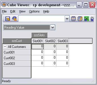

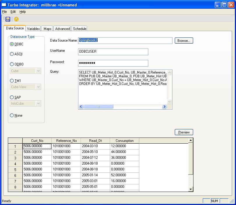

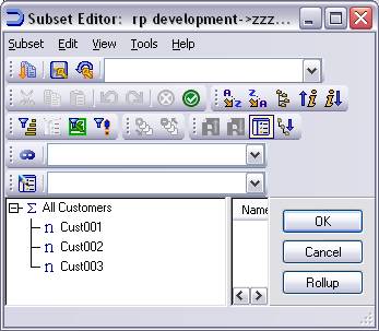

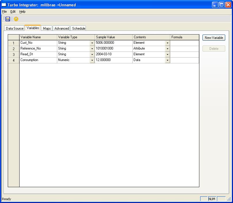

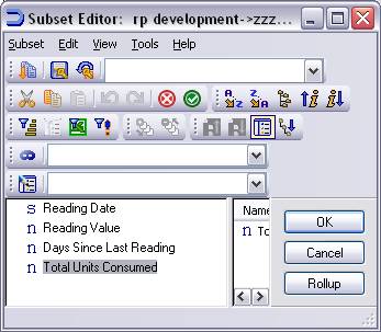

I've attached some screenshots that might help explain it for you. (can't put them inline due to changes IT have done to IE over night to prevent this major flaw from hitting us :/). It shows a 3d cube and the elements within each dim. Every client would then have a numeric attribute to determine which "slot" was last (all starting at 0). As you load the data, +1 to that attribute and that will determine which slot to load the value to. You can then load the reading and date to the cube and use a rule to determine the days since last reading and total consumption if needed.
- Picture4.jpg (24.31 KiB) Viewed 10731 times
- Picture3.jpg (22.14 KiB) Viewed 10732 times
- Picture2.jpg (23.07 KiB) Viewed 10731 times
- Picture1.jpg (20.49 KiB) Viewed 10731 times
