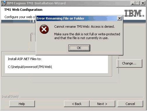

When we Install FP2 we unfortunatly get prompt with this message (see picture attached):
"Cannot rename Tm1Web" : access is denied. Make sure the disk is not full or write protected and that the file is not currently in use.
There is plenty of disk space.
We tryed to run the install after shutting down Tm1 Excel service with the same result. (FP1 install shutdown this service automatically).
InstallTm19.4 - FP2-.JPG (31.39 KiB) Viewed 3569 times
Would anybody have an idea on how to resolve this ?
HTH
Olivier

AFAIK the Fix Packs are cumulative, so there is no need to install FP1 and FP2. You can install FP3 directly.
BTW, why are you upgrading to 9.4MR1 and not to 9.5.1. If I had to make the choice now I would go for 9.5.1.
Michel

I still don't quite understand what would prevent FP2 to come on top of FP1 a it is documented as beeing a possible upgrade as well...
Upgrading to TM1 9.4.1 FP2 Requires 9.4.1 or 9.4.1 FP1 to be Installed
You must have TM1 9.4.1 or TM1 9.4.1 FP1 installed before upgrading to TM1 9.4.1 FP2.
We will try to upgrade to FP3 directly andsee how it goes...
We had to go 9.4 as we have an agreement to keep our licencing schema with this version.
If we move to 9.5 we have to go for named licence which will have budget implications...
HTH
Olivier

Install FP3 directly on top of 9.4MR1 Tm1 web install + Tm1 client did the trick.
All fine now.
Thanks again Michel for pointing that out.
HTH
Olivier
