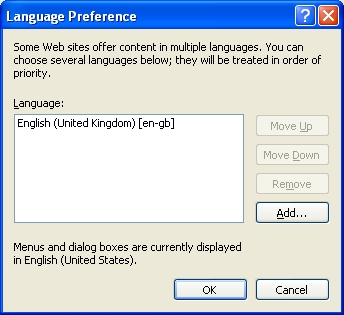

I checked our settings and we only have English available as a language (see attachment).
Now the problem is even getting weirder as since yesterday the language has been back to English. It also happened in the past that the language was set to Spanish or other languages.

Hello Arnaud,
you are using "English (United Kingdom) [en_gb]" as the primary language in your web browser settings. What happens if you switch the primary language to "English (United States) [en_us]" ?
Same for French:
What happens if you switch the primary language from "French (Canada) [fr_ca]" to "French (France) [fr_fr]" ?
