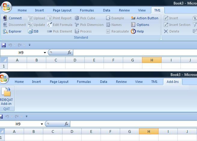

If I deactivate the TM1 ribbon, the TM1 ribbon disappears but I have no Add-Ins ribbon.
If I then open another add-in (as in the 2nd screenshot), the Add-ins ribbon appears, however there is no TM1 menu in the Add-in.
Screenshot of Excel Ribbon

Dan:
I'm confused by your screenshot. You say the ribbon is disabled, but I still see a TM1 tab there. How are you disabling the TM1 ribbon add-in? Typically I just rename the tm1pRibbonX.xlam file so that TM1 won't be able to find it when loading TM1P.XLA in Excel. If the TM1P.XLA add-in can't find the ribbon add-in (tm1pRibbonX.xlam), that is when it populates various items on the Add-Ins tab (assuming macros are enabled and all that).
