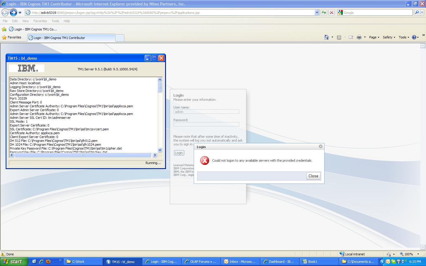

I have installed TM1 Contributor on my laptop, but when I try to logon I get the following error message "Could not logon to any available servers with the provided credentials.".
I already have a server that I have started before logging in.
Can someone please advice?

It used to work, but it seemed to have stopped working. I am trying to log on to TM1 Contributor through IE. I have added a screenhsot.
- Cont Error.JPG (146.26 KiB) Viewed 7666 times

make sure that edivb5319 and localhost are in the Local Intranet sites for IE (Tools, Internet Options, security, advanced). You get that error sometimes when the sites are not in that list (credentials get stripped).

or else you can try using Firefox and see if you have the same problem.
If its working in Firefox then it means it has something to do with the IE settings.

to resolve this issue remove this part from pmpsvc_config.xml (webapps\pmpsvc\WEB-INF\configuration\pmpsvc_config.xml) and restart IE
<admin_host name="localhost">
<servers>
<server name="planning sample" />
</servers>
</admin_host>

Note that these details may be in the fpmsvc_config.xml file
