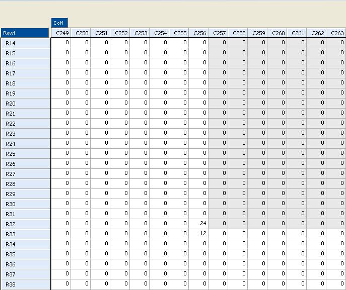

I have a dimension with close to 500 values in it and am having strange issues with it. I tried to simplify and am able to see part of my problem in there. Just created a dimension called 'Row1' with values in it from R1 through R300. On the same lines created another dimension 'Col1' with values C1 through C300. Now create a test cube using these 2 dimensions. Open the cube, set Col1 dimension as Column and Row1 dimension as Row. Scroll all the way to right where you can see C256 and C257 in columns.
These are some of the things (see attachment #1) -
1) The display from C256 through C300 and are all greyed! But we can still enter data in it
2) Scroll downwards and past R32 they are displayed in white!
3) I entered sample values 12 and 24. When I hit F9, the grey area disappears
4) If I now scroll, completely to right and then scroll up to the top.
5) Now scroll left and down to come back to the intersection where sample values are entered. Grey area comes back! AND Depending how you scrolled left, the value 24 is repeated (see attachment #2)
I am able to see this locally on my PC as well as on the server (64 bit installation). Wondering if any of you have seen this before?

- TM1 Screen1.JPG (83.64 KiB) Viewed 8957 times
- TM1 Screen2.JPG (107.76 KiB) Viewed 8957 times

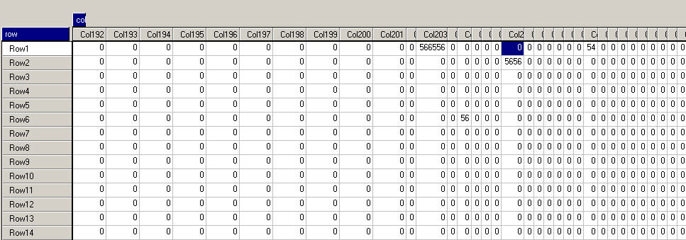

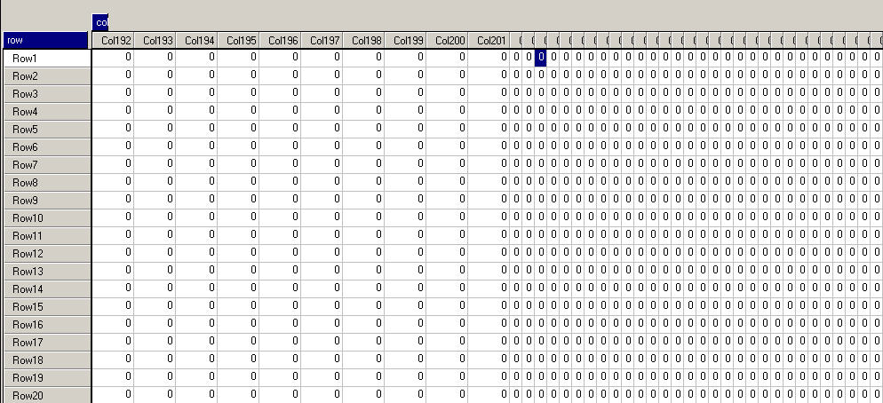

This is so strange. I have tested this in version 9.5.1 and I get the same gray cells as you. I also tried to recreate the dimensions and cube but the issue is still the same.
I have another environment 9.1 SP3 and the result is bit different - I am not getting any gray cells and I can do the data entry in all the cells but the Column headers are not visible until I enter the date into these cells. See the attached screen shots from version 9.1 SP3.
- View after some data entry
- Test_GrayCells2.jpg (93.46 KiB) Viewed 8871 times
- View without data entry
- Test_GrayCells1.jpg (135.81 KiB) Viewed 8871 times
