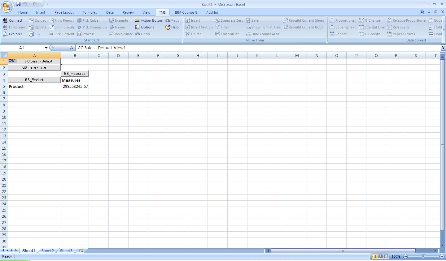

Hello Frnds,
I am very new to Cognos TM1. I have installed 9.5.1 and able to see TM1 tab in Excel 2007. But the Active Form tab, Data Spread Tab, Sandbox Tab and majority of the options are greyed out. I am not able to figure out what the reason is.
Can you guys help me out here.
Anit

Here what exactly do you mean by context sensitive? cause even if i click on any other cell or for that matter any other sheet, still they remain inactive.
Also, about the environment. I am working for a POC, so have installed all the Server/Client on my local machine. Its a standalone environment and my requirement is to create a cube from using one of the Framework Manager packages which we already have. After creating the cube, we want to write back data to the cube based on some calculations.
Hope i am able to explain my requirement. Please do let me know if there is another approach to do what i am trying to do.

Context sensitive in the same way that typically all office menus toolbars and ribbons are context sensitive. That is buttons are enabled when they have relevant functionality to the current selection, otherwise they are greyed out and inactive.
In your case from the pattern of buttons that are inactive it would appear that you are not logged on to a server. If you are in fact logged on try opening server explorer and slicing out a cube view as this may reset the ribbon. If that does not work try an Excel restart. If you still have issues there may be an add-in conflict, try selectively disabling any other add-ins.
