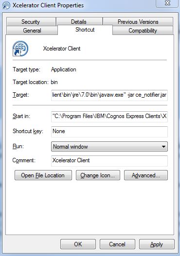

The properties in the Xcelerator Client shortcut
In which:
Target - "C:\Program Files\IBM\Cognos Express Clients\Xcelerator Client\bin\jre\7.0\bin\javaw.exe" -jar ce_notifier.jar"
Run - "C:\Program Files\IBM\Cognos Express Clients\Xcelerator Client\clientnotifier"
I'm unsure on whether this is correct or not but if it isn't, Why would this changed at the first place?

by Alan Kirk
RCO wrote: The properties in the Xcelerator Client shortcut
In which:
I understand the client install is completely independent of the server except when it's logged in, but what riddles me is the fact that right after the server restart every user started having the same problem including me as an admin.
Ah. I may need to leave this one to someone who has used Cognos Express, which I must confess I haven't. I thought that Xcelerator was the name that IBM used this week for the TM1 Excel client, which that is clearly not a shortcut to. javaw.exe is the non-console incarnation of my dear "friend" Java. That shortcut is in fact launching a Java application, which would explain why it certainly won't launch Excel... unless there's something in the Java package which launches Excel but that would seem to be a roundabout way of doing it.
Re: Disable TM1 to auto load in Excel
Posted: Tue Mar 10, 2015 10:50 pm
by declanr
Haven't got a copy of 10.2 Express available to check at the moment but I'm fairly sure it should still just point to tm1p.xla
As to what has happened globally to redirect it...
Edit - I lied; I just checked a copy of CX 10.1 I have and that does point to a javaw.exe file (it works fine by the way)
Posted: Wed Mar 11, 2015 3:51 pm
by lotsaram
As far as I'm aware the main thing (possibly the only thing) the javaw.exe launcher does is to check the server version versus the installed client version. If the client doesn't match the server version then the user is prompted to go to the CX homepage and download the new client and it refuses to launch tm1p.xla. This is an annoyance because as we all know older client / newer server is is no problem.
Changing the link to a direct shortcut to tm1p.xla should work, no reason why it wouldn't.
Posted: Wed Mar 11, 2015 10:45 pm
by RCO
Thank all for your replies, we have changed the link to a direct shortcut to tm1p.xla so users can launch Perspectives.
I still don't understand what was the cause of this issue but what matter the most is that it works now.
Thank you so much for your help :D

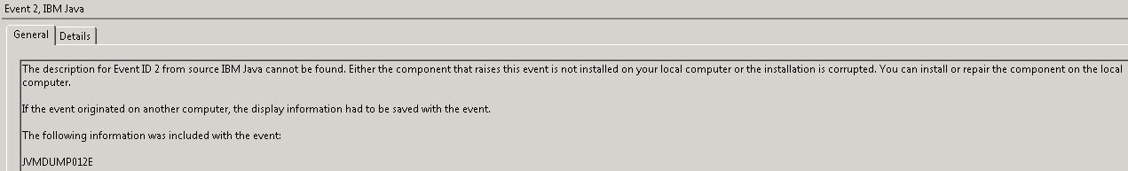

by RCO
The IT team found below error in the windows event view "JVMDUMP012E"
Has anyone seen this error type or know what it means?
Posted: Mon Mar 16, 2015 12:38 am
by Alan Kirk
RCO wrote: The IT team found below error in the windows event view "JVMDUMP012E"
According to this link it's time for a trip to your friendly support team.
JVMDUMP012E
Error in %1$s dump:%2$s
Explanation
The JVM detected an error while attempting to produce a dump.
System action
The JVM continues, but the dump might not be usable.
User response
Refer to diagnostic information or contact your local IBM® service representative.
