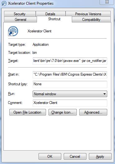

Re: Disable TM1 to auto load in Excel
Hi Alan,
Thank you so much for your kind and detailed reply.
I have previously check the DDE option in excel and it is Unchecked, so have now gone to the Default Programs in windows 7 and the .xla file type is still associated to MS excel.
The properties in the Xcelerator Client shortcut
In which:
Target - "C:\Program Files\IBM\Cognos Express Clients\Xcelerator Client\bin\jre\7.0\bin\javaw.exe" -jar ce_notifier.jar"
Run - "C:\Program Files\IBM\Cognos Express Clients\Xcelerator Client\clientnotifier"
I'm unsure on whether this is correct or not but if it isn't, Why would this changed at the first place?
I understand the client install is completely independent of the server except when it's logged in, but what riddles me is the fact that right after the server restart every user started having the same problem including me as an admin.
In which:

Ah. I may need to leave this one to someone who has used Cognos Express, which I must confess I haven't. I thought that Xcelerator was the name that IBM used this week for the TM1 Excel client, which that is clearly not a shortcut to. javaw.exe is the non-console incarnation of my dear "friend" Java. That shortcut is in fact launching a Java application, which would explain why it certainly won't launch Excel... unless there's something in the Java package which launches Excel but that would seem to be a roundabout way of doing it.RCO wrote: The properties in the Xcelerator Client shortcut

- Posts: 1833
Haven't got a copy of 10.2 Express available to check at the moment but I'm fairly sure it should still just point to tm1p.xla
As to what has happened globally to redirect it...
Edit - I lied; I just checked a copy of CX 10.1 I have and that does point to a javaw.exe file (it works fine by the way)
Thank you Declan for your reply.
Just like Alan, I'm also struck by the fact that this has happened on all machines at once and after a server start. According to one of the guys at our IT team (I'm in finance by the way) they haven't changed anything at all, I will investigate further thought..
Are there any files in the server that are somehow linked/used by the client Java application that launches Perspectives? Some sort of register?
Sorry if this sounds silly but this issue goes beyond my knowledge now.

It just opens the excel add in (as far the eyes can see - obviously doing something extra behind the scenes) which is why I assumed it pointed directly to the xla file.Alan Kirk wrote:When you say it works fine, do you mean that it launches Excel and the add-in, or launches some entirely Java-based client as a "replacement"?declanr wrote:Haven't got a copy of 10.2 Express available to check at the moment but I'm fairly sure it should still just point to tm1p.xla
I would hazard a guess (and it is just that) that it may somehow send a notification of some variety to the Cognos Express Manager (the web GUI overview screen thing); but to be honest my involvement of using Cognos Express has always just been to set it up and use it exactly as I would use TM1 and/or Cognos BI - I tend to ignore the extra clunk that comes with it as my clients rarely want to know about any of that.RCO wrote:Are there any files in the server that are somehow linked/used by the client Java application that launches Perspectives? Some sort of register?
As far as I'm aware the main thing (possibly the only thing) the javaw.exe launcher does is to check the server version versus the installed client version. If the client doesn't match the server version then the user is prompted to go to the CX homepage and download the new client and it refuses to launch tm1p.xla. This is an annoyance because as we all know older client / newer server is is no problem.
Changing the link to a direct shortcut to tm1p.xla should work, no reason why it wouldn't.
Thank all for your replies, we have changed the link to a direct shortcut to tm1p.xla so users can launch Perspectives.
I still don't understand what was the cause of this issue but what matter the most is that it works now.

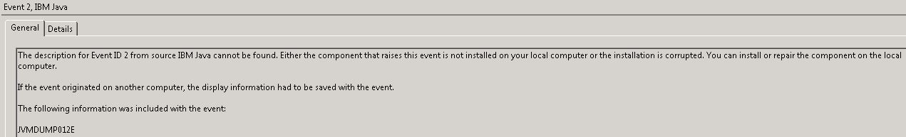

The IT team found below error in the windows event view "JVMDUMP012E"
Has anyone seen this error type or know what it means?
- Posts: 6672
According to this link it's time for a trip to your friendly support team.RCO wrote: The IT team found below error in the windows event view "JVMDUMP012E"
The JVM is pretty good at producing dumps; it's a thought that crosses my mind every time I fire up Performance Muddler.JVMDUMP012E
Error in %1$s dump:%2$s
Explanation
The JVM detected an error while attempting to produce a dump.
System action
The JVM continues, but the dump might not be usable.
User response
Refer to diagnostic information or contact your local IBM® service representative.
A huuuuuge, warm, gently steaming dump, sitting on your screen just waiting to be trodden in.
But that aside, from the sounds of it the JVM might not have been usable either after this happened. The key question is why. It's a question that you should definitely put to Support. I'd also be wondering if maybe you have automatic Java updates on. If one of those broke the JVM (or at least IBM's use of it) at your site it would explain why everyone's shortcut died at the same time.
