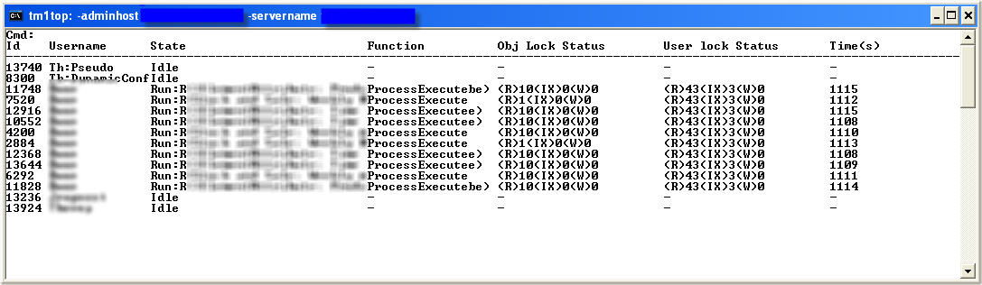

It looks as if you try to execute 2 TI processes in parallel by 1 user thread. This will not work. Every TI process you intend to run in parallel must be executed by it's own user thread.
Try that:
- Start the TM1Top tool to monitor user thread activity.
- Start the first TM1 Architect session, thus starting the first user thread.
- Start the second TM1 Architect session, thus starting the second user thread.
- Simultaneously, in the first TM1 Architect session start the first TI process, and in the second TM1 Architect session start the second TI process.
- The TM1Top tool should display both user threads in a run state, both accumulating CPU time.
